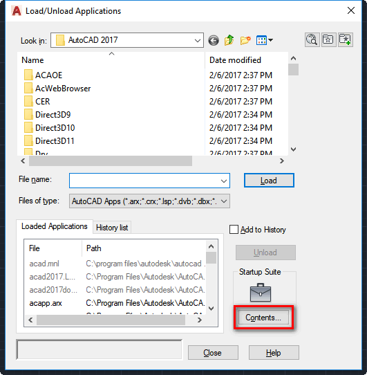

  1. In your AutoCAD command line type APPLOAD and hit enter
  2. Under Startup Suite, click the Contents... button
