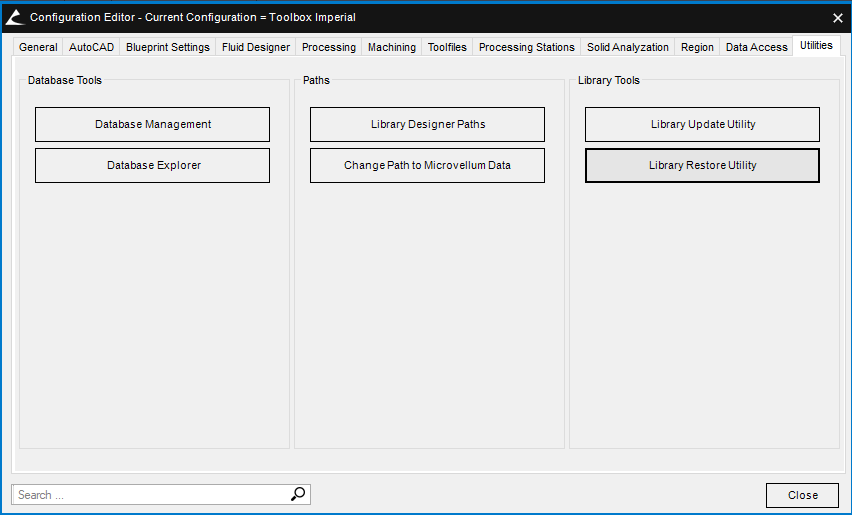

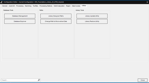

2. Open Microvellum Toolbox and select "Options" from the Toolbox Setup drop-down menu.
3. Select the "Utilities" menu on the far right of the dialog box and then select the "Library Update Utility" button.

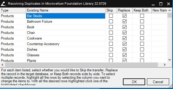

6. Depending on the update file size, after a few minutes a Resolving Duplicates interface will appear. If there are certain products you do not want overwritten, this interface will allow you to skip the update for this particular product, or keep it along with the updated version.

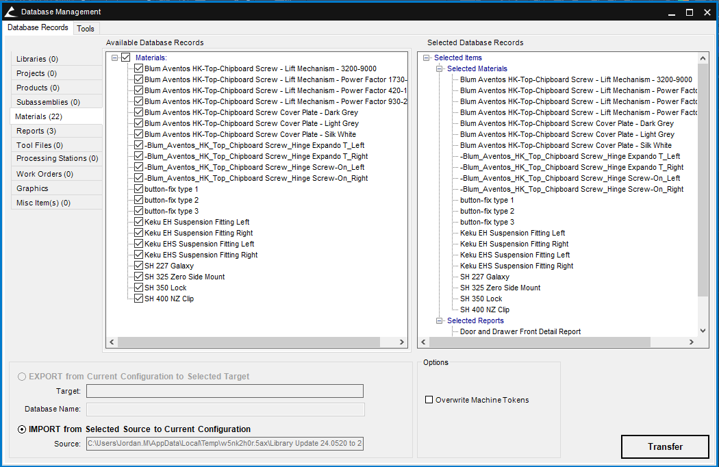

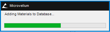

7.  After the first screen in which one resolves duplicates, a progress bar indicating the stages and status of various processes will appear. After these processes have been completed, one will have the Database Management window pop up to request a transfer between the existing database and the update package's contents. Click the "Transfer" button. Another duplicate resolution screen may or may not pop up, depending on the size of the update.

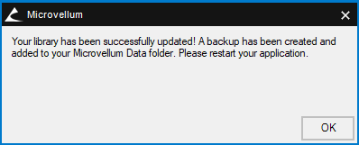

8. After the update has been completed, a pop-up will appear informing you that the process has been completed.

When updating, one will be faced with a progress bar that is not indicative of the update processing, but rather, an indication that the system is prepared for the transfer. When this pop-up is on the screen, it means the Database Management window is open and ready for transfer.
9. Restart Toolbox.

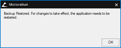

1. In the Options menu, under the Utilities tab, select the “Library Restore Utility” button.

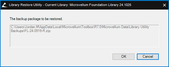

2. A menu will appear indicating the most recently created backup of your library. Toolbox will only restore your most recently created backup file.
3. Select “OK” and wait for your backup package to restore your library to its pre-update state. Another alert will appear when the process has been completed.
4. Restart Toolbox.
