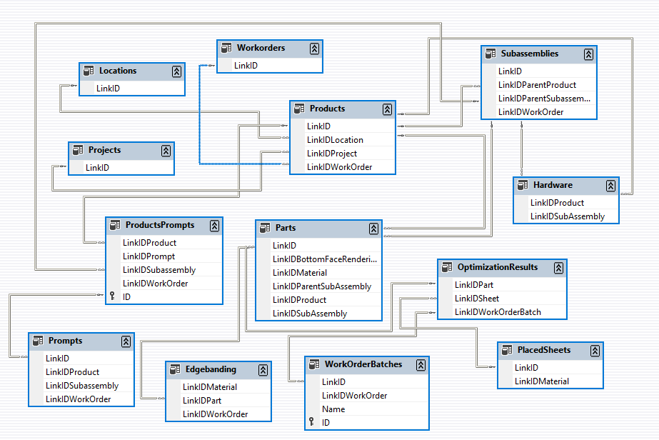

Work Order Entities
This relation outlines the relationships between common Work Order Entities.

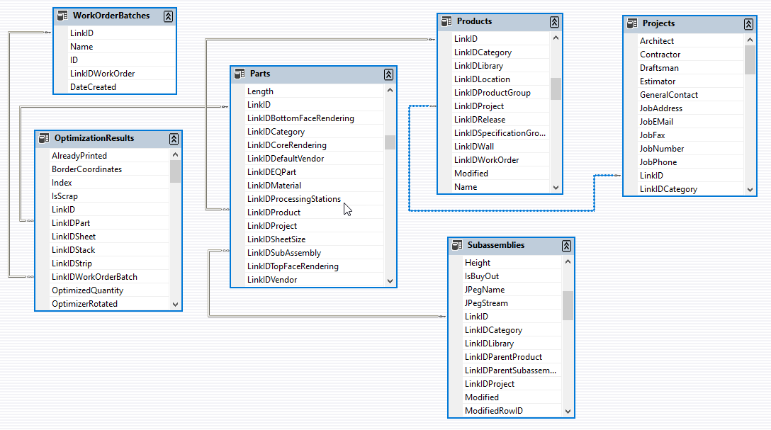

Master Cut Report by Work Order
NOTE: this report does not use data from batch processing
This report groups part data by: 1) Materials.
This report uses data from the following Work Order Tables: Projects, Products, Subassemblies and Parts. The relationships are as follows:
Master Cut Report by Batch
NOTE: this report uses data from batch processing
This report groups part data by: 1) Batch and 2) Materials.
This report is the same as the Master Cut Report by Work Order except for the addition of the Work Order Batches and OptimizationResults tables. The addition of these two tables allows new relationships between the Parts, OptimizationResults and a WorkOrderBatches tables.
Nesting Optimization Report
This report is displays each nest layout with the parts being cut.
This report uses data from the following Work Order Tables: WorkOrderBatches, Projects, Products, Parts, OptimizationResults, PlacedSheets, Sheets and MaterialStorageLocations. The relationships are as follows:
Parts by Processing Station
This report groups part data by: 1) Batch and 2) Processing Stations.   Parts not processed will show up a the end of the report.
This report uses data from the following Work Order Tables: WorkOrderBatches, Projects, Products, Parts, ProcessingStations and PartsProcessingStations. The relationships are as follows:

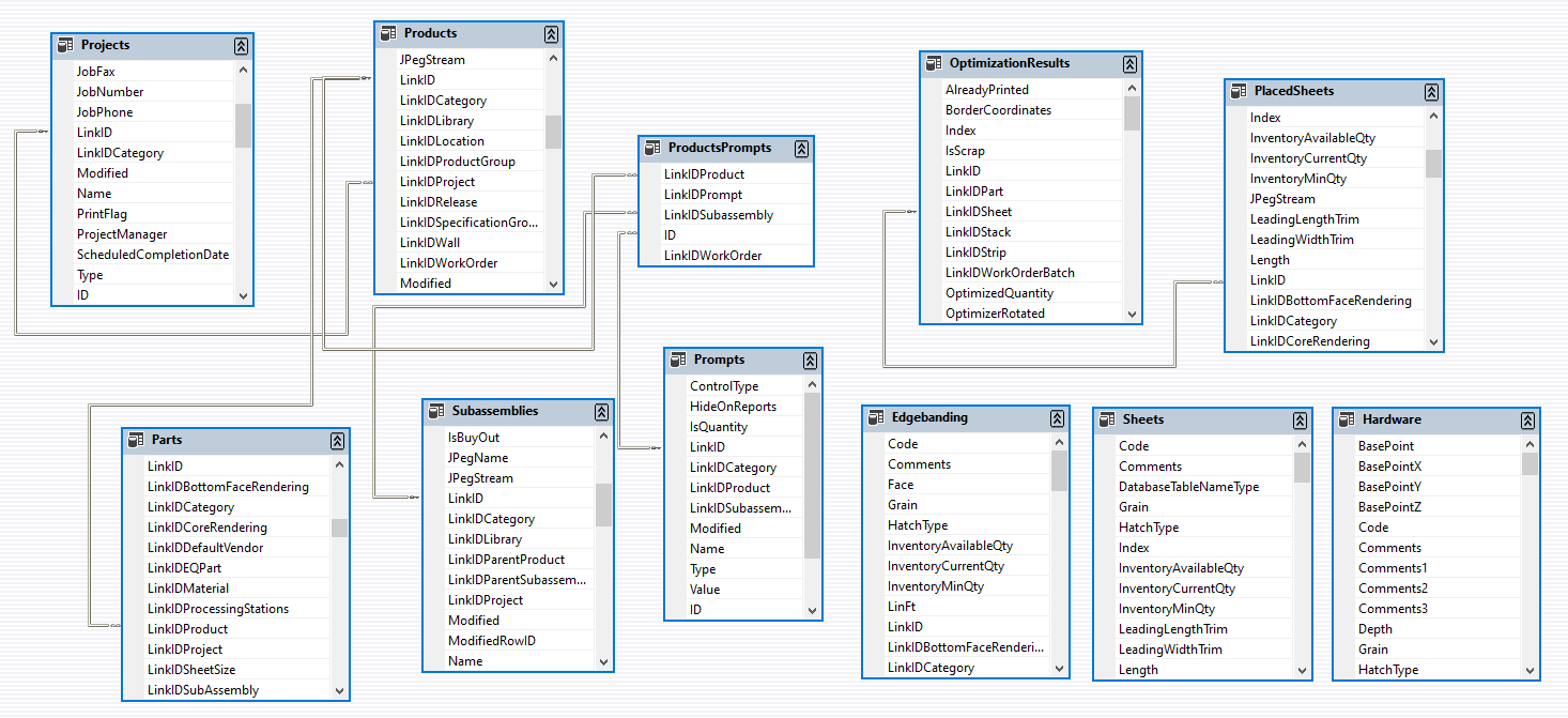

Product Detail Report
This report groups data by: 1) Product.   It displays a hardware list, subassembly list, and part list for each Product.
This report uses data from the following Work Order Tables: Projects, Products, Subassemblies, Parts, Hardware, Prompts and ProductPrompts. The relationships are as follows:
Product Detail with Image Report
This report groups data by: 1) Product.   It displays an isometric image, hardware list, subassembly list, and part list for each Product.
This report uses data from the following Work Order Tables: Projects, Products, Subassemblies, Parts, Hardware, Prompts, ProductPrompts and FaceFrameImages. The relationships are as follows:
Work Order Summary Report
NOTE: This report uses data from batch processing
This report groups data by: 1) Room.   The second section of the report displays batch sheet summaries along with solid stock, buyout, edgebanding and hardware totals.
This report uses data from the following Work Order Tables: Projects, Products, Subassemblies, Parts, Hardware, Edgebanding, Sheets, PlacedSheets, Prompts, ProductPrompts and OptimizationResults. The relationships are as follows:
