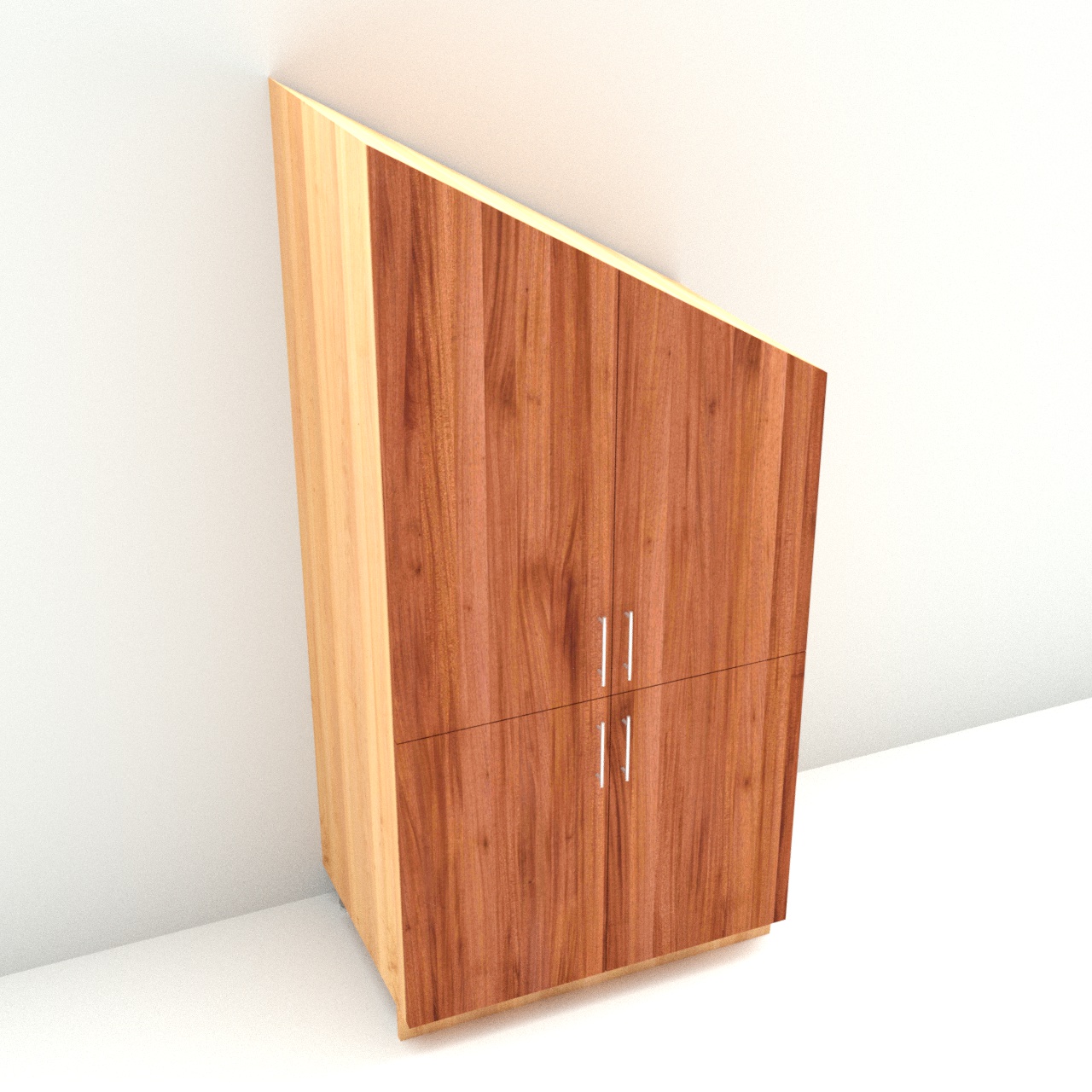

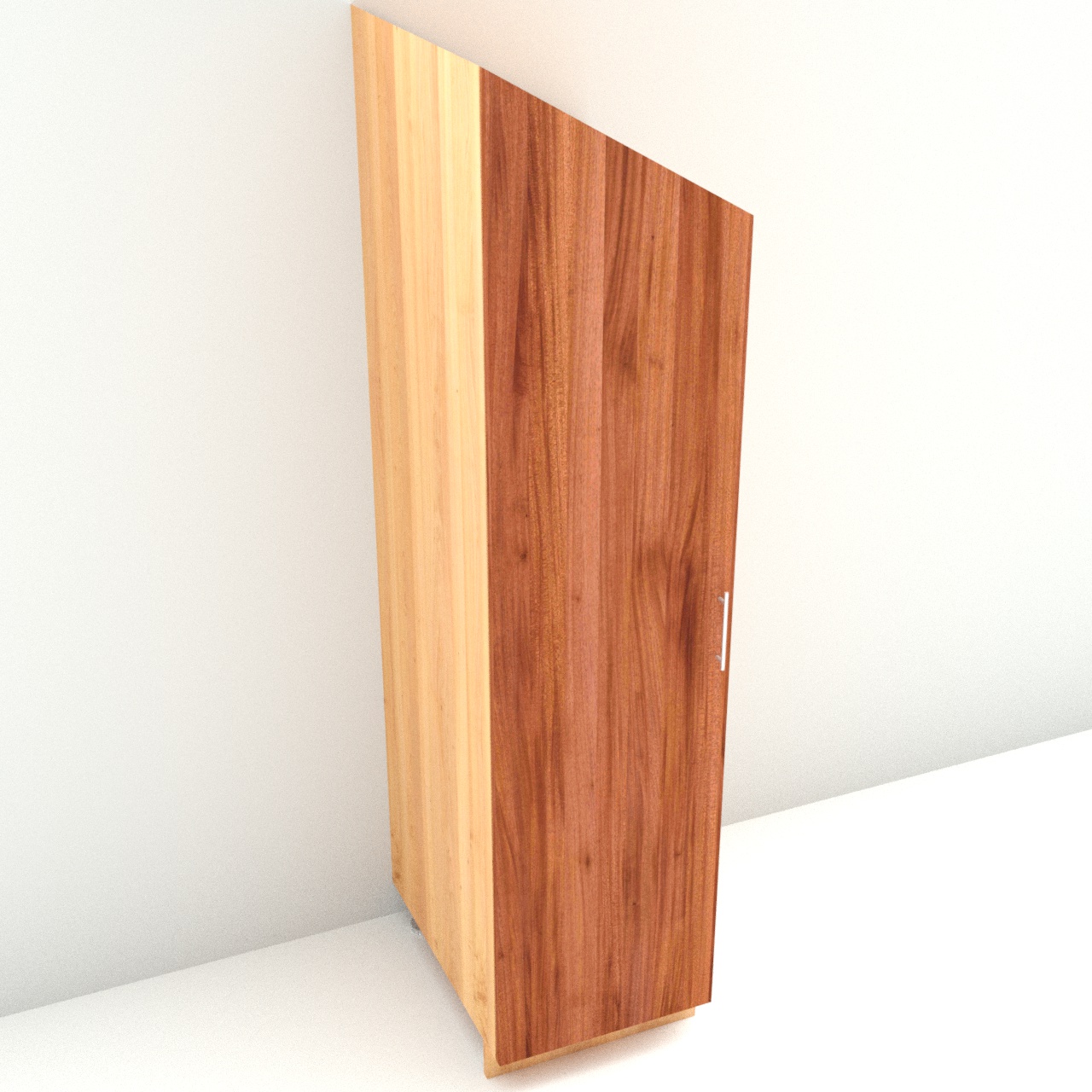

  1. Added the Master Angled Ends Cabinet.

  9. Added Under Stair Cabinets:
    1. Under Stair 1 Door
    2. Under Stair 2 Door
    3. Under Stair Vertical 2 Bay Cabinet
