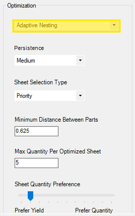

Adaptive Nesting
Fig. 1: The Adaptive Nesting setting.
  1. A new setting has been added to the nesting options within nest Processing Stations: Adaptive Nesting. Adaptive nesting is a new setting able to be selected from the dropdown menu under “Optimization”. When selected for an operation, Adaptive Nesting runs the batch through Block Nesting, then True Shape Nesting automatically, comparing the results and setting the option that produced higher yield as the outcome. This removes the need for manual trial and error between the two options on the user end.

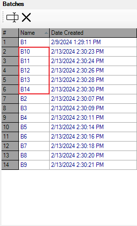

Fig. 2: Batch names sorted incorrectly.
  1. When organizing batches that have been processed via the event log, users reported issues with sorting. It is expected that events and batch names will be sorted alphanumerically in grid view, with times in the event log being sorted chronologically, and batch names being sorted according to the number of the batch (B2, B3, B4, etc.) However, some users found this was not the case, with event logs and batch logs instead being erroneously organized according to the first digit. This issue has been resolved; items should now appear alphanumerically as intended.

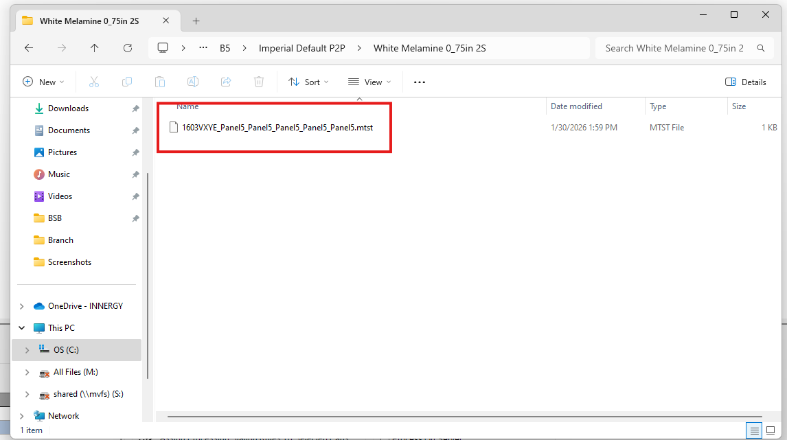

Fig. 3: A custom file name repeating and compounding with each batch.
  1. An issue was reported with specific file names. When setting a specific file name for batches via the Custom File Name Field in the IPP Settings, it is expected that the file name will remain consistent and only output what is entered. It was reported, however, that this would instead result in file names compounding with each successive batch, eventually resulting in a file name too long to be accepted as a file path. This issue has been resolved and should no longer occur.

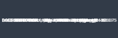

Fig. 4: A part list jumbled into a single line.
  1. When using the MVPARTLIST command, it is expected that the part list will be drawn in model space in an organized grid format. However, it was instead reported that the list of parts would instead be drawn in a jumbled, illegible fashion, with all the text placed together in a single line. This issue has been resolved; when creating a parts list using the command, it should now display properly.

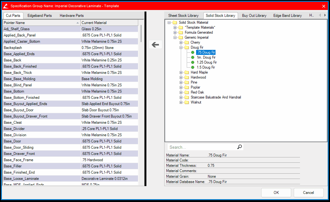

Fig. 5: The Vendors option not working when opened in the Solid Stock library.
  1. There was a reported issue with the Vendors option in the Specification Group UI. Namely, when attempting to display information on vendors from the interface (visible from the Material File), clicking on the option would not open any subsequent windows or show any information. This occurred when clicking the option for any material library other than the Sheet Stock Library. This issue has been resolved, and vendors should now be accessible from all material libraries in the UI.
