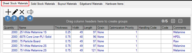

Sheet Stock Materials
Fig. 05 – Sheet Stock Materials

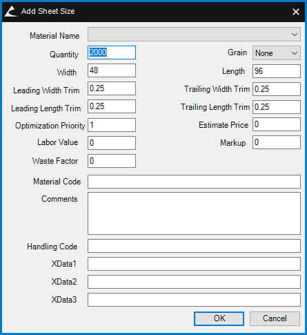

- Add New Sheet – Allows the user to add a new sheet with parameters of their choosing. See Figure 06.
Fig 06 – Add Sheet Size
- Edit Selected Sheet – Allows the user to edit the parameters of an existing sheet. The modifiable parameters are the same as in Figure 06.
Sheet thickness cannot be changed without reprocessing the work order.
- Delete Selected Sheet – Allows the user to delete the selected sheet.

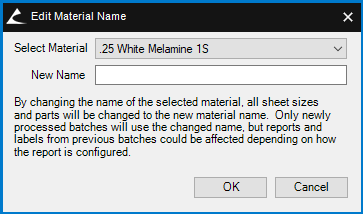

- Change Material Name – Allows the user to change the name of a particular material. Select the material to be changed in the dropdown, and enter the new name.
Fig. 07 – Edit Material Name
By changing the name of the selected material, all sheet sizes and parts are changed to the new material name. Only newly processed batches use the changed name, but reports and labels from previous batches could be affected depending on how the report is configured.

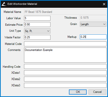

- Edit Selected Sheet – Allows the user to edit the parameter of an existing sheet. See Figure 09 for the modifiable parameters.
Fig. 09 – Edit Workorder Material (Solid Stock Materials)

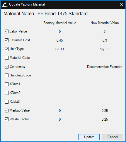

- Update Factory Material – If edits were made to the sheet from the Edit Selected Sheet interface, selecting Update Factory Material opens a window showing these new values and the Factory Material Values. Selecting the checkboxes next to the parameters that have changed, and clicking update updates the material at the factory level. See Figures 10 and 11.
Fig. 10 – Update Factory Material

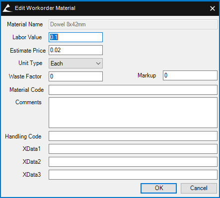

- Edit Selected Sheet – Allows the user to edit the parameter of an existing sheet. See Figure 16 for the modifiable parameters.
Fig. 16 – Edit Workorder Material (Hardware Items)
