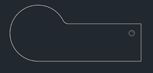

"P" Shaped Worktop Orientations
Products with the "P" shaped worktop have four different orientation options:
P External Left
P External Right
P Internal Left
P Internal Right
