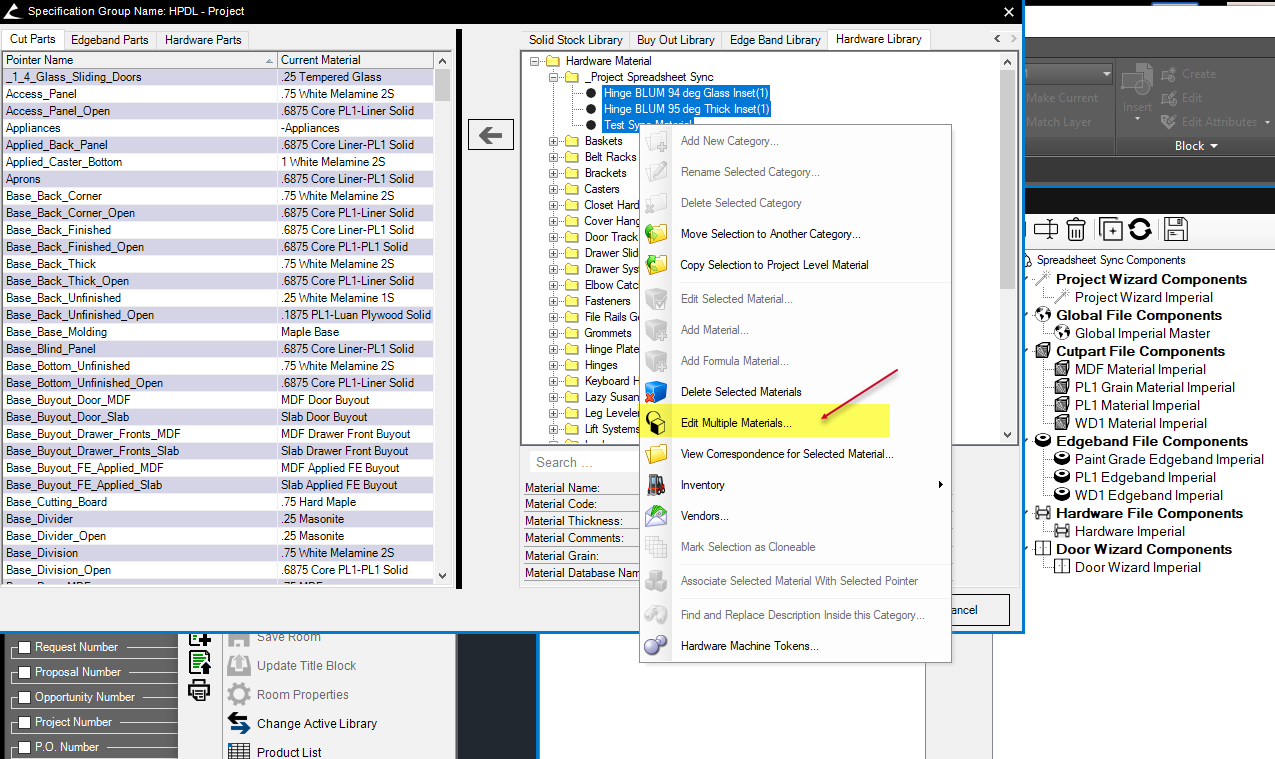

The value for “Skip Spreadsheet Sync” is not stored in the spreadsheet, so you cannot edit that property for multiple materials there. Instead, use the Edit Multiple Materials interface to change that property for multiple materials at once.
Fig. 3 – Edit Multiple Materials Access
Fig. 4 – Edit Multiple Materials Interface
