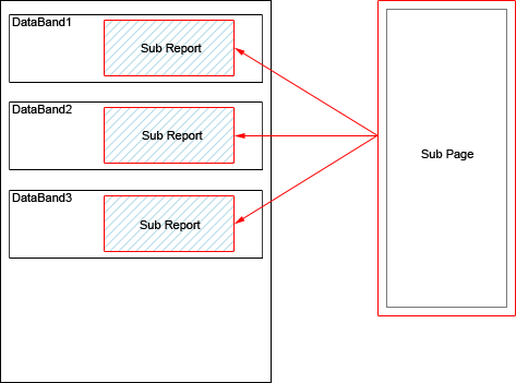

The Sub Report component can be placed on the Data Band. When rendering a report, the Sub Report is rendered as the item of the Data Band, so it is printed in each Data Band. Figure 01 shows the scheme of the rendering of the sub report when placing the Sub Report component in the Data Band:
Fig. 01 – Sub Report Components on Data Bands
In this case, the height of the component on the sub report page of a report is higher than the height of the Sub Report component. So the Sub Report component is placed in the Data Band and rendered as the item of the Data Band, and, in this case, the Can Grow property works, and the component can grow by height.
