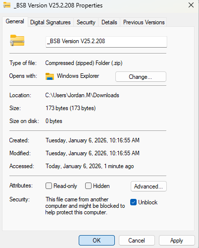

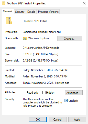

  2. Right-click on the installation package, select "Properties" from the menu, and once inside the properties, scroll to the bottom of the settings and click the "Unblock" option, then "Apply" and "OK".
Fig. 1: Unblock the install package under "Properties".

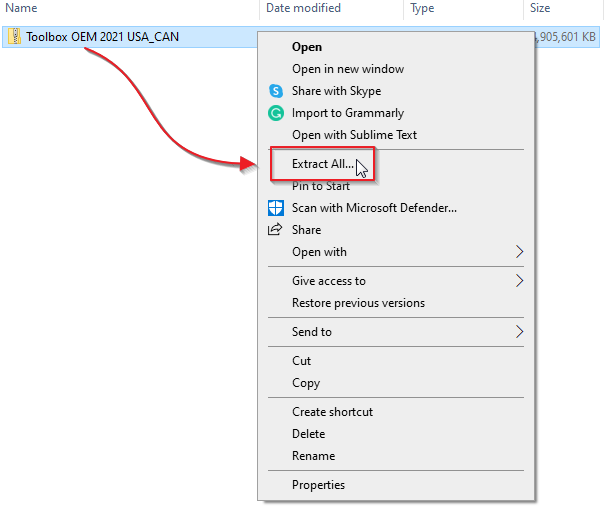

  1. If the file is a ZIP, you must extract the contents by right-clicking on the file and selecting "Extract All." Alternatively, if you are using another file compression app, extract it using that app.
  2. Info
    Specify a location to extract the installation package directly on the C:\ drive, or at C:\Temp\ to reduce long filename issues. Otherwise, you may have issues with rendering files with longs names not being installed correctly.
    Fig. 2: Extract the install package.

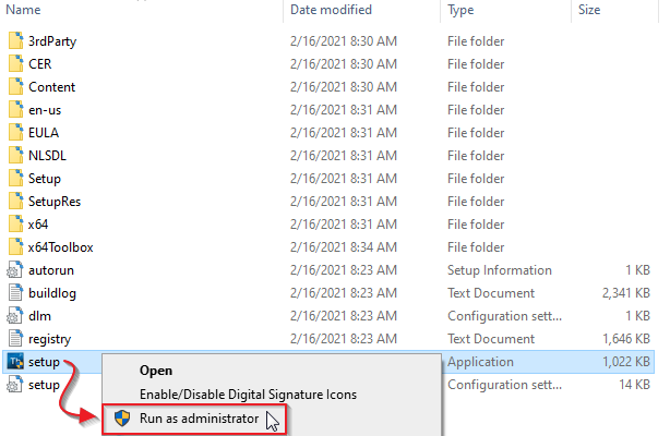

  3. Once you've done that, then find the file named "setup.exe" and right-click on it. Select "Run as Administrator."
  4. Fig. 3: Run as an administrator.

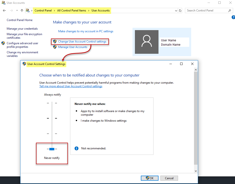

  6. If you still have issues with the install failing, TEMPORARILY modify your UAC or User Account Control settings. To do so, press the Windows key on your keyboard and enter "Change User Account Control Settings." Set the slider to "Never Notify."
    • Windows 8 - Control Panel > User Accounts > User Accounts
    • Windows 10 - Control Panel > All Control Panel Items > User Accounts > Change User Account Control Settings
    • Fig. 4: UAC settings in Windows.
