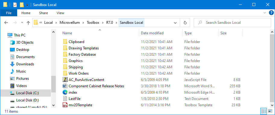

  4. Create a Copy of the folder containing the Factory Database, Work Orders, etc… Name the copied folder “Sandbox Local."
  5. NOTE: To save time and Hard Drive storage, you may want to create your Sandbox Local folder structure and pick and choose just a few test projects and work orders to copy along with your core Microvellum data, instead of copying the whole folder structure and all contents.
  6. Enter the “Sandbox Local” folder -> enter the “Factory Database” folder.

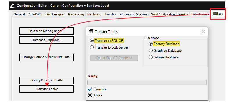

  11. Select the “Utilities” tab > Select “Transfer Tables” > Select the radio buttons “Transfer to SQL CE" and “Factory Database” > Select “Transfer” (see below).
