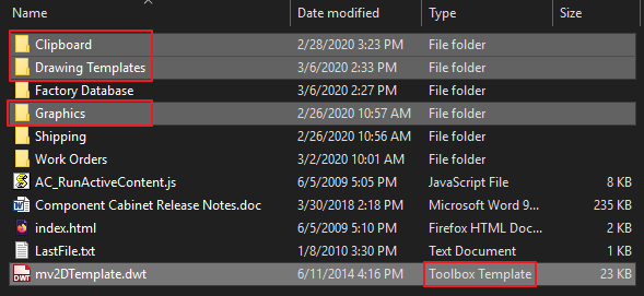

    1. Select the "Help" tab from the primary Toolbox palette and select "Browse to Factory Data."
    2. Copy the "Clipboard," "Drawing Templates," and "Graphics" folders as well as the Toolbox Template file.
    3. Go up a folder level by selecting the "Up" arrow -> On this level, create a new folder named "Sandbox Server" -> Paste the items copied above into this folder.
    4. Within the "Sandbox Server" folder, create two new folders named: "Factory Database" and "Work Orders."
    5. Populate the "Factory Database" folder by copying five of your most recent project folders, or particular projects you wish to test, from the original "Factory Database" folder. Do the same for the "Work Orders" folder.
    6. The entire "Microvellum Data" folder could be copied and renamed to: "Sandbox Server." We recommend only choosing an assortment of your most recent projects and work orders strictly for speed purposes. Depending on the number of projects and work orders you have, the process of copying the entire "Microvellum Data" folder could take a long time.

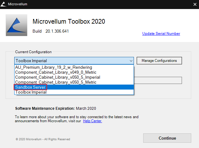

  3. Restart Toolbox.
  4. Select "Manage Configurations."
  5. Copy the SQL server configuration and rename it "Sandbox Server."
  6. Start Toolbox in the "Sandbox Server" configuration created in the last step.

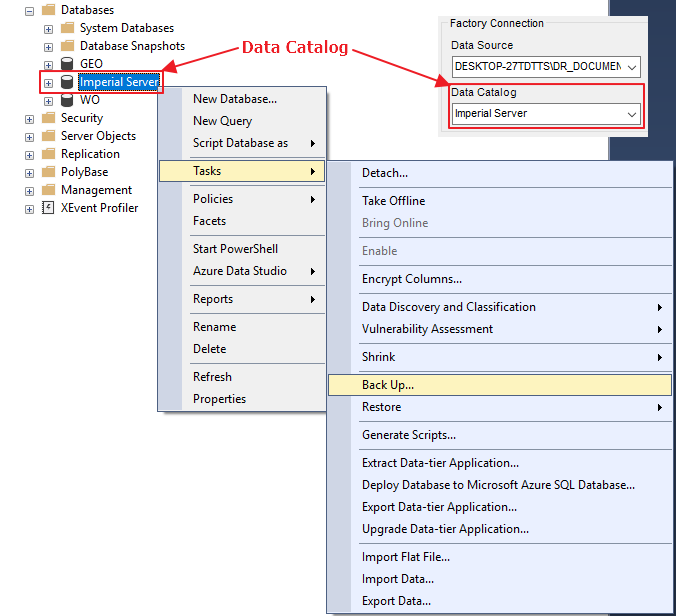

  1. Open SQL Server Management Studio.
  2. Right-click the existing Data Catalog and select “Tasks” > “Back Up...”
  3. The existing Data Catalog is found in the "Data Access" tab of the Options menu in Toolbox.
  4. Make sure that the Backup Type is set to "Full."

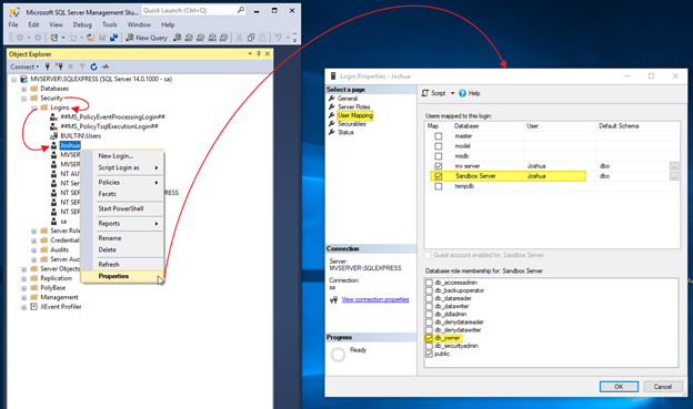

  9. Navigate to folder "Security" > "Logins."
  10. For user who needs access to Sandbox Server, right-click user > "Properties" > "User Mapping" > Select "Sandbox Server" and add role membership "db_owner" > select "OK."
