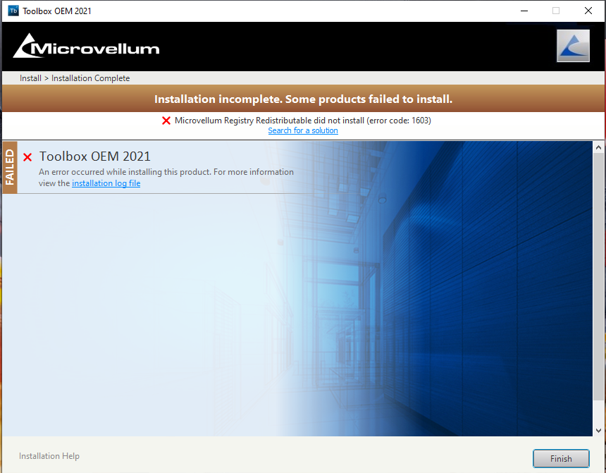

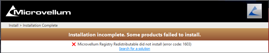

Issue:
While installing any Microvellum product the user gets error code 1603 or gets the error message “Cannot find Setup.dll”.
Resolution:

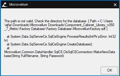

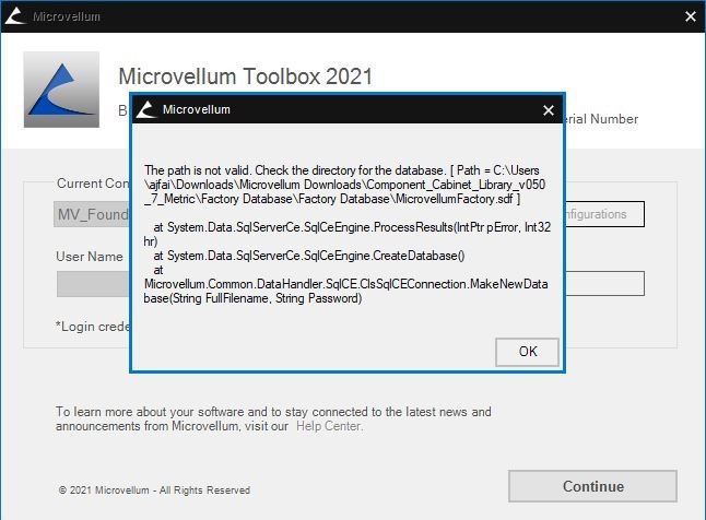

Issue:
While booting up any Microvellum product the user gets the error message: “Path is not Valid”.
Resolution:
Close any open Microvellum products.
Open File Explorer and path to your current configuration: C:\Users\<username>\AppData\Local\Microvellum\Common Microvellum Data.
Open your current configuration and copy the path.
Open the Registry by clicking the Windows button and typing “RegEdit”.
Browse to your current configuration: HKEY_CURRENT_USER > SOFTWARE > Microvellum > Toolbox > R(Version) > Toolbox > Configurations.
Select your current configuration and double-click the string named “PathToMicrovellumData."
Replace the “Value Data” with the path that you copied.
Close the Registry Editor and restart the software.
