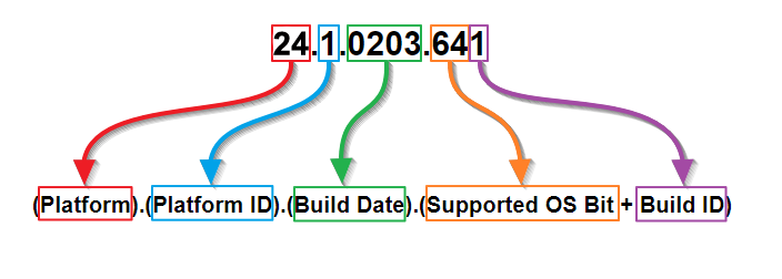

Microvellum's software build numbering schema is as follows:
  • Platform: The platform supported by the build, or the year that the build was released. The platform number reflects the highest CAD platform version or year supported.
  • Platform ID: An incremental number that is linked to the Platform and Build Date. If the Platform spans more than one calendar year, the Platform ID will increment to 2, 3, etc. In a normal development cycle, the Platform ID should not exceed 2.
  • Build Date: A calendar date referencing the day the software build was made.
  • Supported OS Bit: Identifies the supported operating system bit type, either 64-bit or 32-bit (otherwise known as “x86” or “86”).
  • Build ID: The Build ID increments when more than one build is created on the same day.
