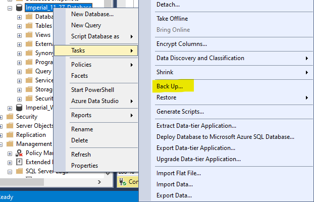

The most straightforward method of backing up the data in your SQL database is to simply manually do so in SQL Server Management Studio (SSMS). There is a native task in SSMS allowing users to manually back up their data via a simple interface. For information on how to perform this process, consult this article

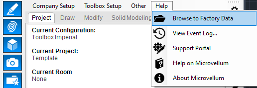

If using SQLCE, an equally simple method to manually back up your data is to locate your data folder, then copy it directly into your backup location via file explorer. Locating your data folder can be done during Toolbox usage by clicking on “Help” then “Browse to Microvellum Data” from the Toolbox interface. Consult this article for an example of how to back up data locally with this method.

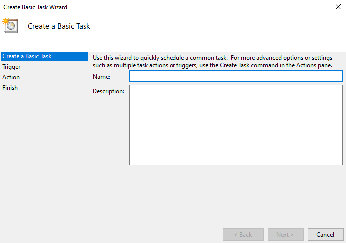

5. Create a Basic Task, naming it appropriately (“SQLBackup” or something similar, for instance), then click Next.

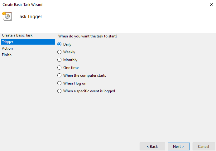

6. Select the appropriate interval of time for the Trigger, depending on how frequently you would like your data to be backed up (it is suggested one select “Daily”), then click Next.

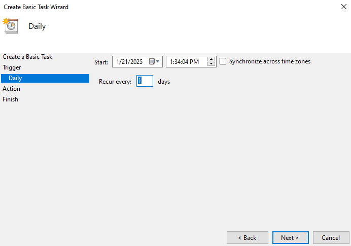

7. Set the start date (the current date is recommended) and the repeating time desired for the task to be undertaken. Then, click Next.

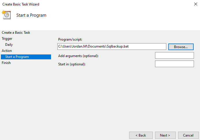

8. Select “Start a Program” in the Action type. Click “Browse” and insert your batch file. Click Next.
