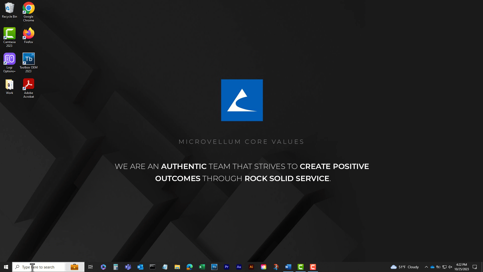

Figure 1: Updating sheet sizes process, demonstrated.
  1. To synchronize sheet sizes in Microvellum, one must utilize the registry editor application in Windows.
  2. To open this application, type "regedit.exe” into the search or start bar on your computer.
  3. Once the application is opened, navigate to the “HKEY_CURRENT_USER” path and select the “SOFTWARE” folder.
  4. From “SOFTWARE” navigate to the “Microvellum” folder, then open “Toolbox”, and one’s current Toolbox OEM version (this will be the folder with the “R” prefix and the current OEM year number).
  5. Open the folder marked "Preferences", then within that, the folder marked "Materials".
  6. On the console, this should open a number of material preferences capable of being modified within the registry. Find the option labeled "UpdateSheetSizes", right-click on it, and select the "Modify" option.
  7. From there, change the value data from 0 (the default) to 1. This update will synchronize the sheet sizes to your workbook.
