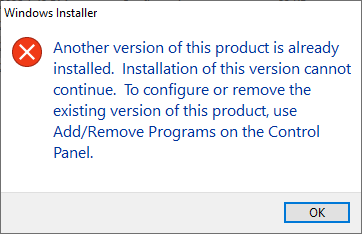

If you choose "Yes" when prompted if you want to allow this application to your device during the installation process, the system will check for compatibility with older versions. However, due to incompatibility issues, you may receive a message requesting that you remove the existing version of the product before continuing with the installation.

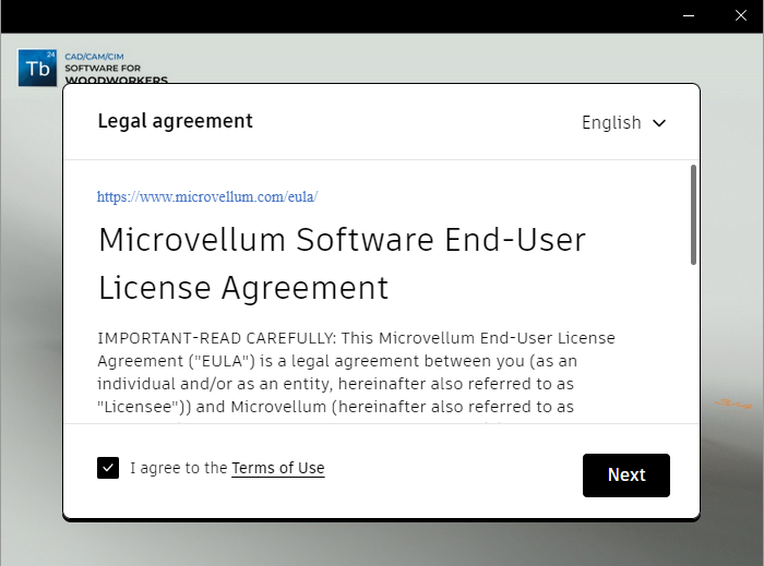

4. In the first window, accept the End-User License Agreement (EULA) by selecting Continue.

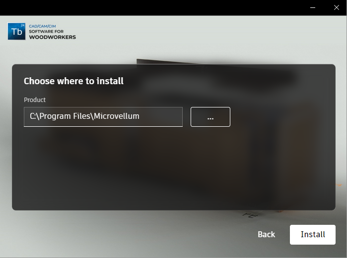

5. Choose the directory for the install. We recommend keeping the default path.

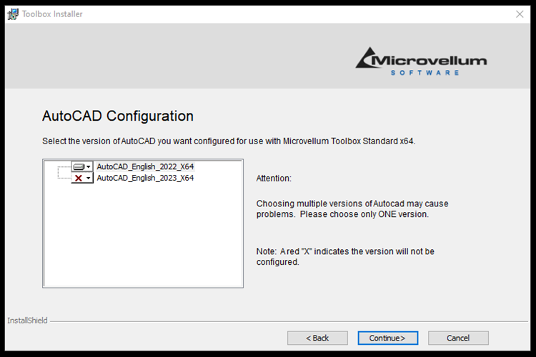

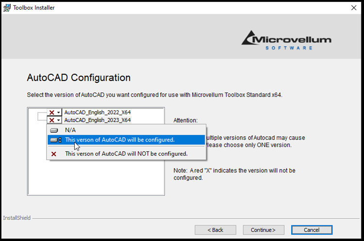

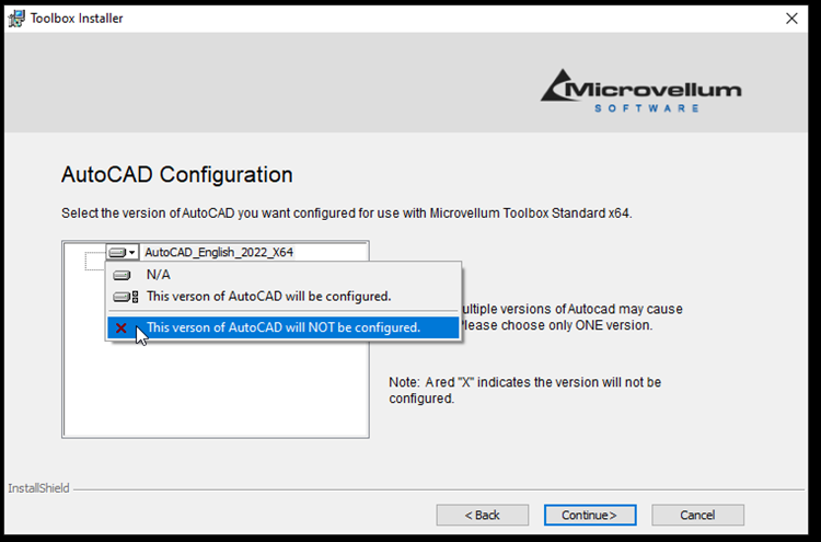

6. The next interface will display a list of supported versions of AutoCAD and prompt you to select the version you want to configure for use with Microvellum Toolbox Standard. From the dropdown menu, choose the year of AutoCAD you wish to configure and select the option "This version of AutoCAD will be configured".
7. Only select one year of AutoCAD to configure and leave the rest as "NOT configured." Once you have made your selection, click "Continue." Upon completion of the installation, launch AutoCAD to begin using the Toolbox Standard.

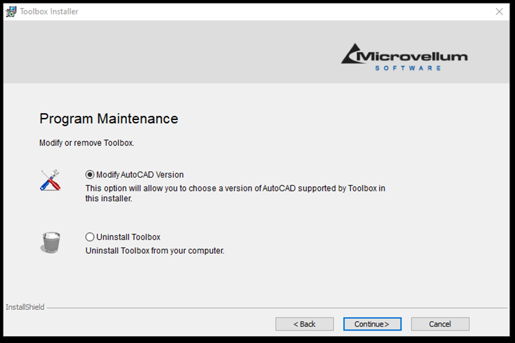

2. When the Modify or Remove screen appears, click "Continue."
3. On the Program Maintenance screen, select "Modify AutoCAD Version" and click "Continue."

5. The next interface will display a list of supported versions of AutoCAD and prompt you to select the version you want to configure for use with Microvellum Toolbox Standard. From the dropdown menu, choose the year of AutoCAD you wish to configure and select the option "This version of AutoCAD will be configured."
6. Just like before, only select one year of AutoCAD to be configured and leave the rest as "NOT configured."
7. After making your selection, click "Continue."
