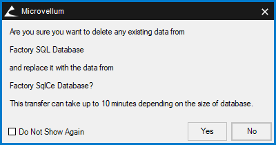

  1. With Toolbox open, click “Toolbox Setup > Options > Data Access > SQL Server” and in the Factory Connection section, click the button “Transfer SqlCe to SQL Server. Allow the transfer to complete and a message box to appear confirming the transfer.
  2. Fig. 1

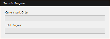

    Fig. 2

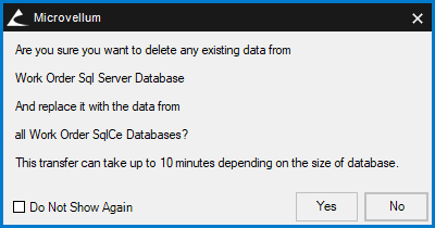

  1. In the Work Order Connection section, click the button “Transfer SqlCe to SQL Server. Allow the transfer to complete and a message box to appear confirming the transfer. The data will be transferred to the appropriate work order or geometry database.
  2. Fig. 3

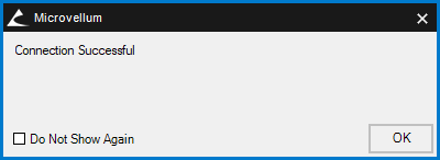

  1. Test the three SQL Server database connections again as you did in the previous tutorial. This time the message box should confirm that the connection was successful, as shown in Fig. 4.
  2. Fig. 4
