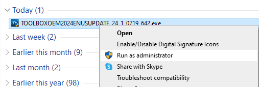

  1. Right-click on the Toolbox update installation file and select “Run as administrator."

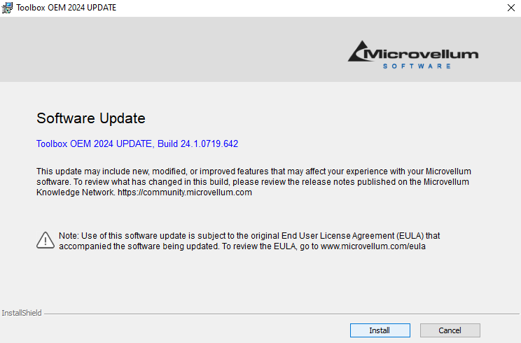

  2.  Begin the installation by selecting “Install.”

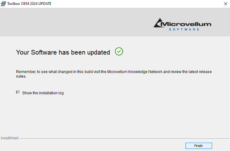

  3. A success notification will appear when the installation is complete.  Click "Finish."
  4. You have successfully updated your Microvellum software.
