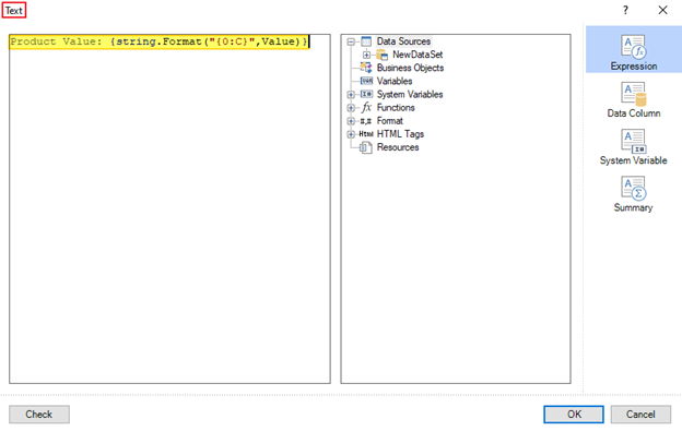

To use the string.Format method in a text component, select the text component for editing, and enter the expression in the text field.
Fig. 01 – string.Format Example
As an example, when the need to format a value as currency arises, use the C specifier:
Product Value: {string.Format(“{0:C}”, Value)}
In the case that Value is 100.00, then after formatting, the line prints as:
Product Value: $100.00
