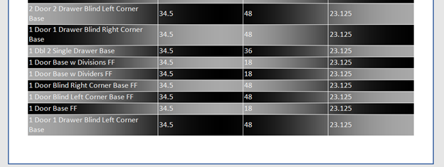

Usually, you have more than one component on a band, as in Figure 01 below:
Fig. 01 – Multiple Components on a Data Band

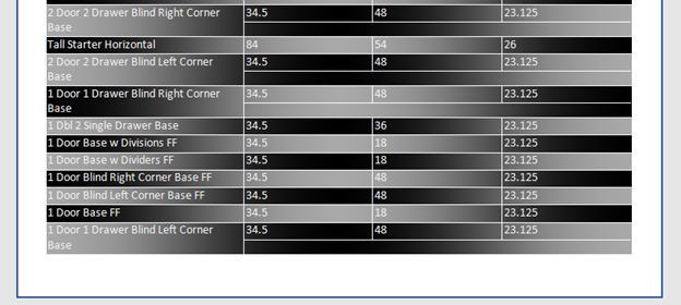

Rendering the report may cause some of the component’s heights to change automatically to suit the size of the contents therein. This automatic changing of height can result in unwanted breaks in the layout, as seen in Figure 02.
Fig. 02 – Unwanted Breaks in the Layout
These unwanted breaks can be avoided by binding the bottom border of a component to the lower border of the band or container in which the component is placed. This binding can be accomplished using the Grow to Height property.

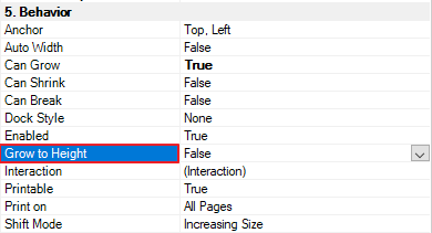

Grow to Height Property
Fig. 03 – Grow to Height Property
When set to true, the Grow to Height property binds the bottom border of all components that do not change size to the bottom border of the band or container in which they are placed.
The Grow to Height property must be applied to the components within the container, not the container itself. It can be applied to all of the components within a container or band.

The Grow to Height property is set to false by default.
