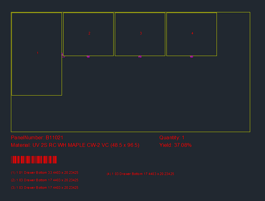

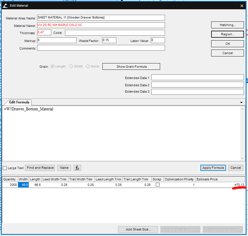

I am inputting sheet stock pricing at the moment to finally get our costing reports set up, and I am having some issues with understanding how the sheet goods are calculated. You can see I have $70.13 for the price of this sheet for drawer bottoms.
When I run the test work order, it is showing 1 sheet and getting 37% yield for the few parts I need.

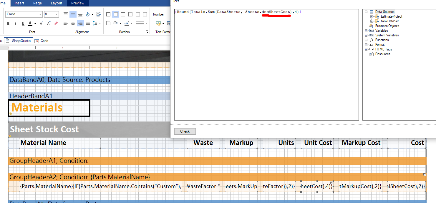

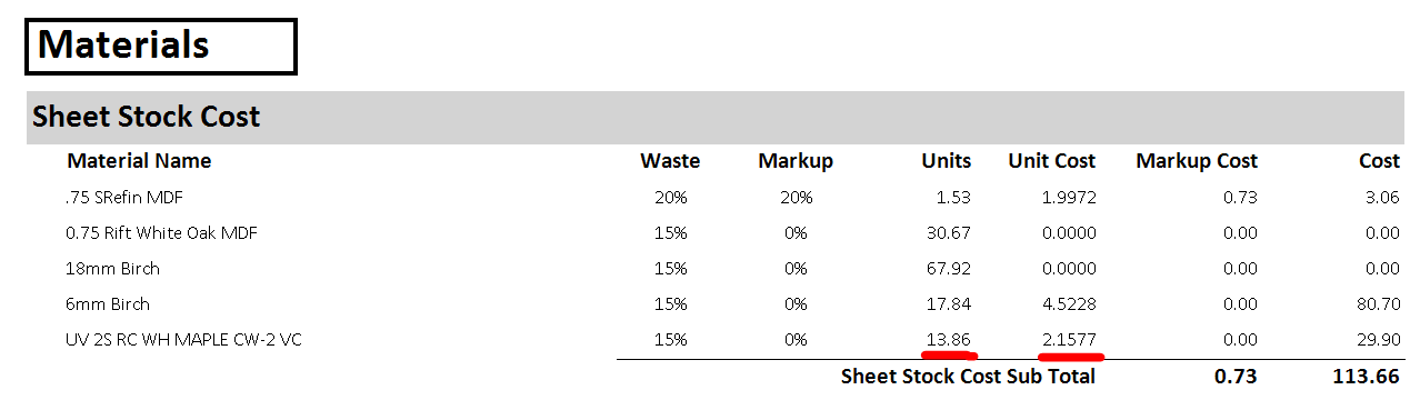

So where are these numbers coming in below? I looked at the data for the reporting but it is bringing in value from the Sheets data table "decSheetCost" but I cannot find that when reviewing the data table.
I don't know. Just not really understanding how this is set up and why it is so off from what it should be.
