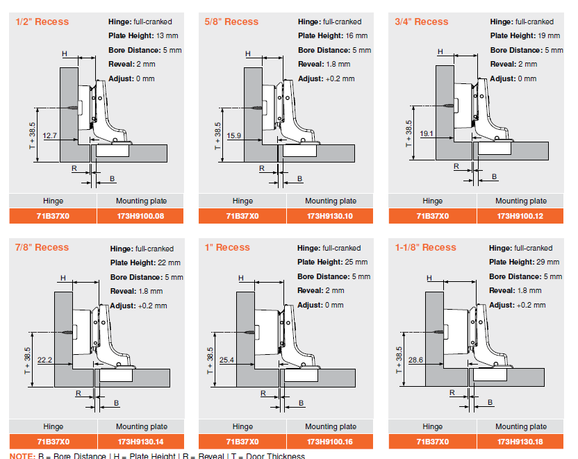

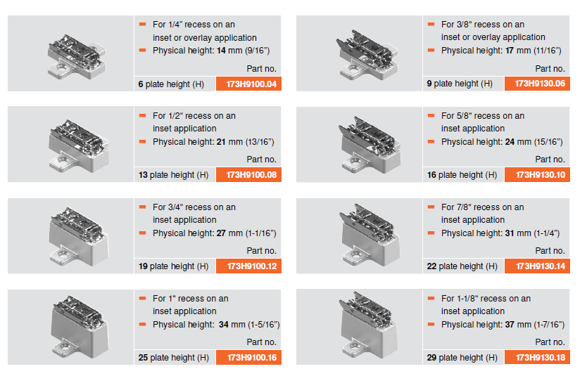

Has anyone added the Tall Blum Hinge Plates for Inset doors and Face Frame use?
Attached is a PDF showing the Mounting plates I am referencing.  Our residential division wants to use these on any of their Inset Door Face Frame cabinets.  They don't like the Face frame adaptor.
The thing I am trying to figure out is how to properly add this to the LookUpTableHingePlates in the CCL.  Because this uses an Overlay Distance but, in this case, the Overlay is a negative number.
