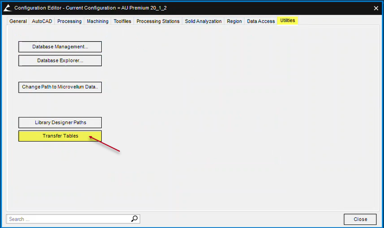

  1. Open Toolbox or the Product Module (ERP) and transfer tables from the SQL Server configuration to a SQL CE local configuration. Access at Options > Utilities > Transfer Tables.
    1. Transfer all three tables to give the local configuration full capabilities for permissions, etc.
    2. Fig. 01 - Transfer Tables Button
      Fig. 02 - Transfer Tables Interface

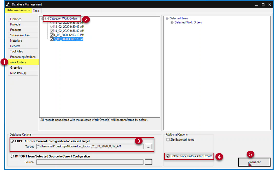

  10. Remove all work orders from the dataset.
    1. Options > Utilities > Database Management > Work Orders, select all work orders, set a path for the exported backup copy, check the box for Delete Work Orders After Export, click Transfer.
    2. Fig. 06 - Database Management Work Order Interface
  11. When asked, verify the work orders to delete.

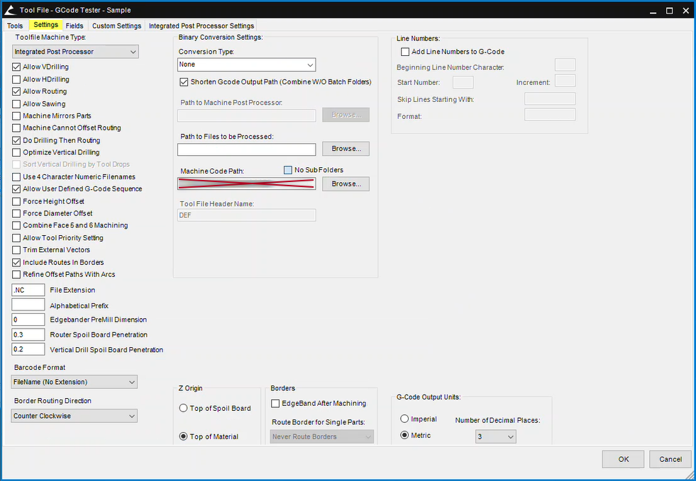

  12. Open all tool files and delete the Machine Code Path in the Settings tab.
    1. If you are running Integrated Post Processing and Labeling, remove the following paths.
      1. Path to Nest Label Images
      2. Path to Nest Label Parts Files
      3. Path to Nest Label Worklist Files
      4. Path to Nest Label Aux Files
    Fig. 07 - Delete Machine Code Path
