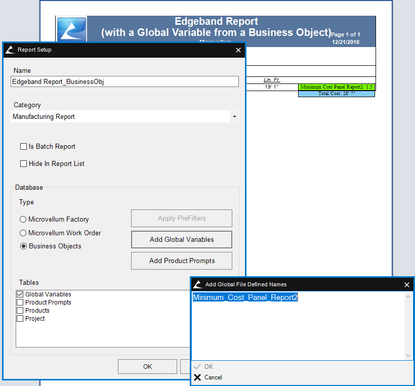

Global variable name:  Minimum_Cost_Panel_Report2
  1. Configure the global variable as a Business Object using the procedures in earlier tutorials. Click the button Edit Data Source from the report viewer screen to enter the Report Setup area to do this.

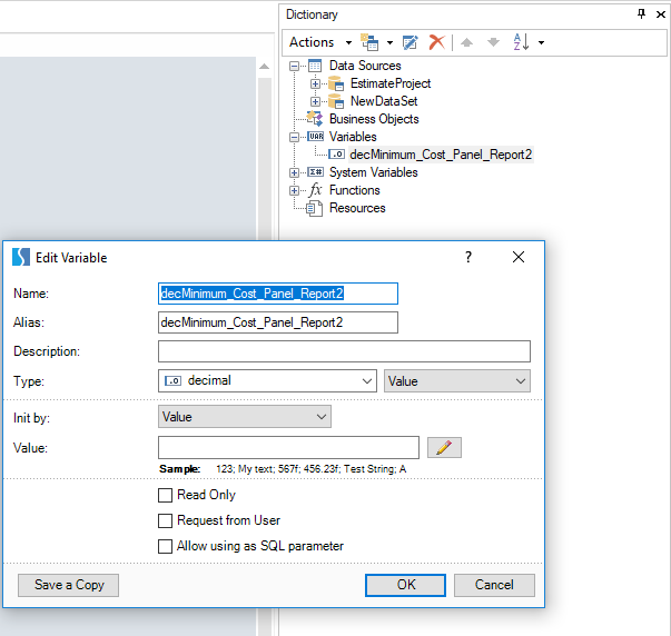

  3. Add and configure a report variable of type decimal to contain the Business Object global value.
  4. Fig. 2

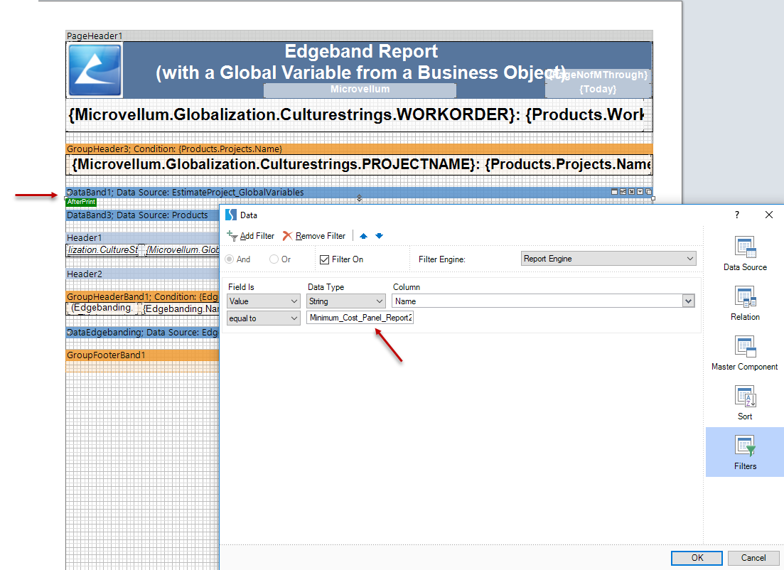

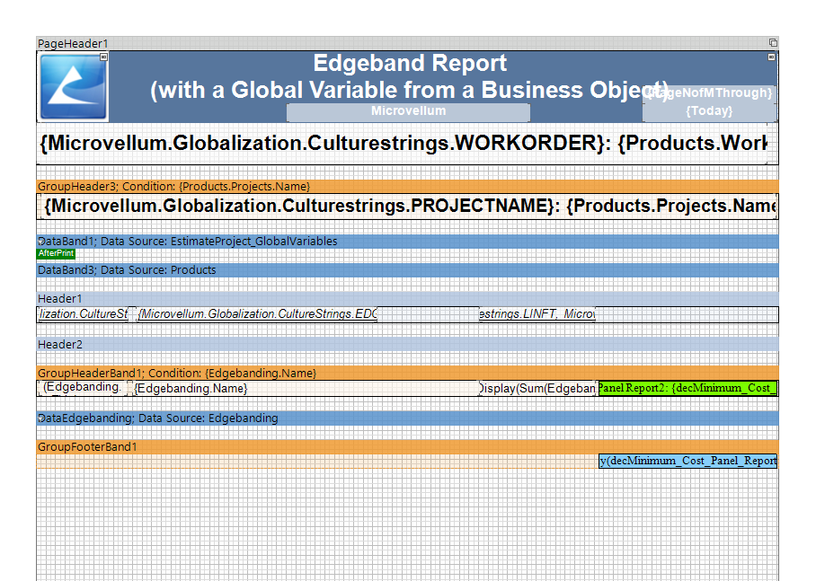

  5. Add a databand and set up the filter for only one specific global variable value.
  6. Fig. 3

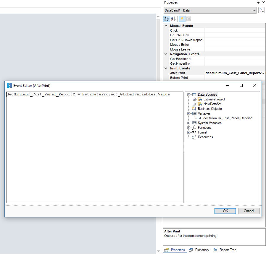

  7. Add event code at the appropriate level for what you are trying to accomplish. In this case, it should be in the After Print event and should be the following value: decMinimum_Cost_Panel_Report2 = EstimateProject_GlobalVariables.Value.
    This expression sets a variable value with a global variable value.
  8. Fig. 4

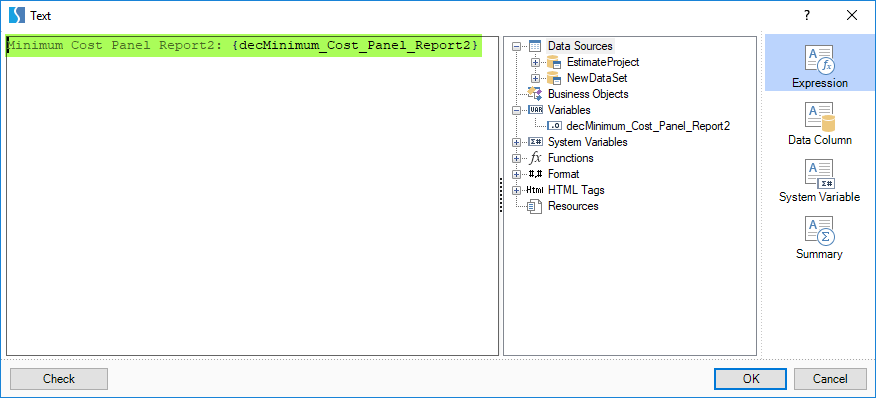

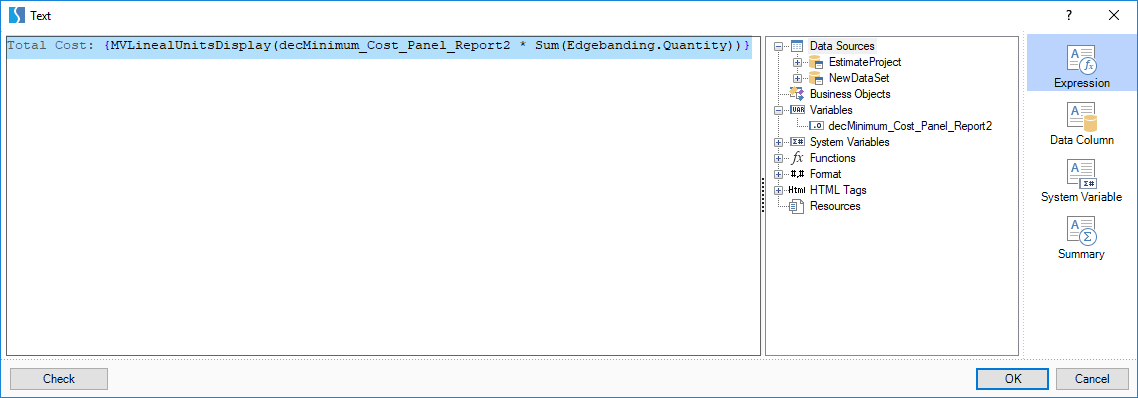

  9. Add text components to display the variable value, and one to perform a calculation on that value.
  10. Fig. 5
    Fig. 6
    Fig. 7

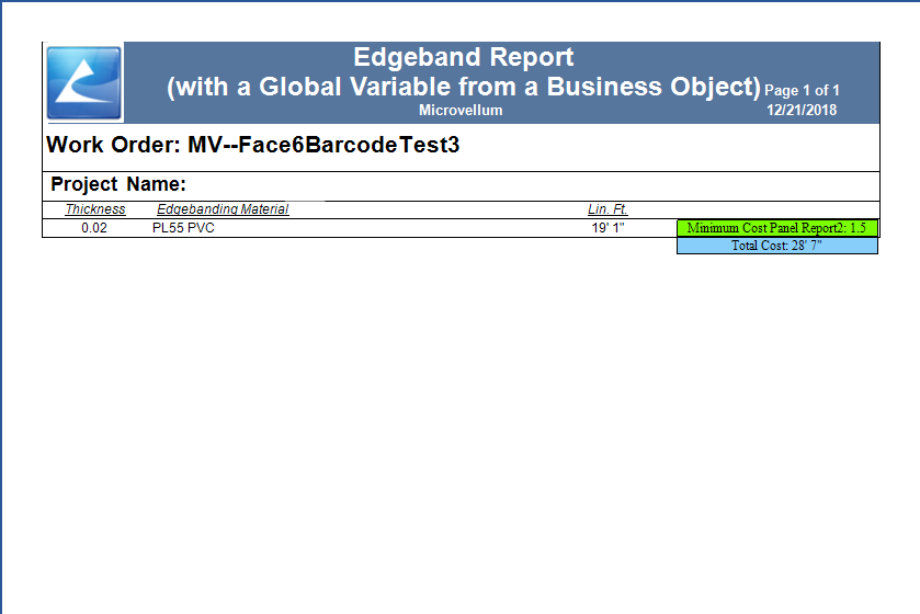

Here is the rendered report:
Fig. 8
