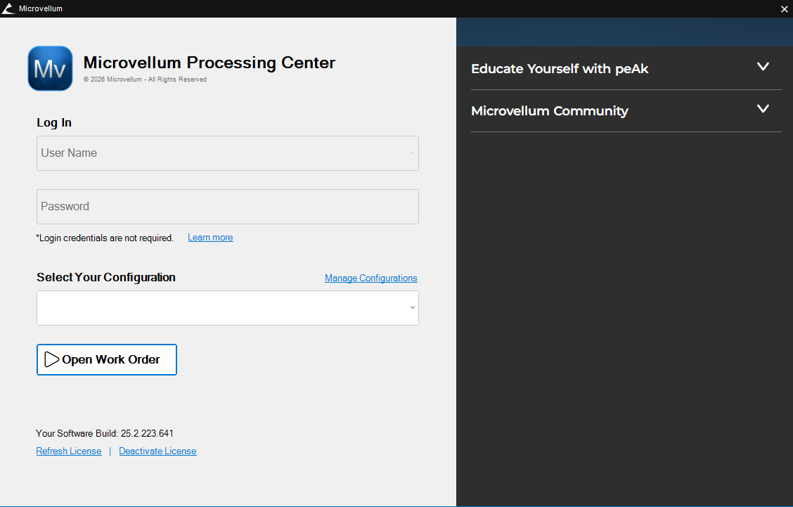

Microvellum Processing Center Application
The standalone Processing Center application provides shop-floor tools for managing and executing manufacturing data generated from Microvellum projects.
It enables users to:
  1. Print part labels
  2. View and print reports
  3. Create and re-create manufacturing data
  4. Manage part remakes
  5. Re-optimize output
  6. Create and manage batches
  7. Review G-code and other production results
This standalone software delivers the established Processing Center functionality in a lightweight, purpose-built application designed specifically for shop-floor environments.
