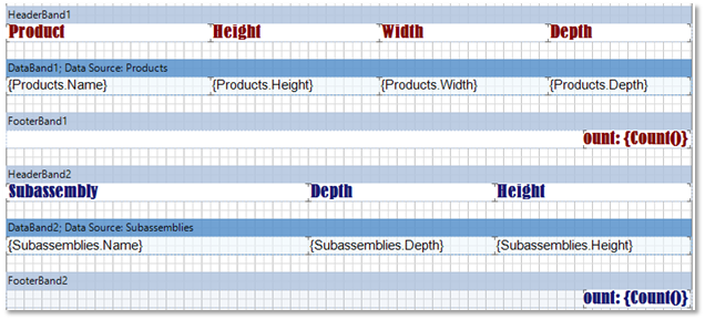

  1. Place two Data Bands on a page, and specify them with different Data Sources. In Figure 01, I’ve added Text Components and pointed them towards Data Columns.
  2. Fig. 01 – Two Data Bands in the Report Template
  3. Create a header and a footer for the Data Bands. When adding multiple lists, you will need to add multiple headers and footers. The Header Band should be placed directly over the Data Band it corresponds with, and the Footer Band should be placed under it.
  4. Fig. 02 – Multiple Lists – Note Header and Footer Band Placement

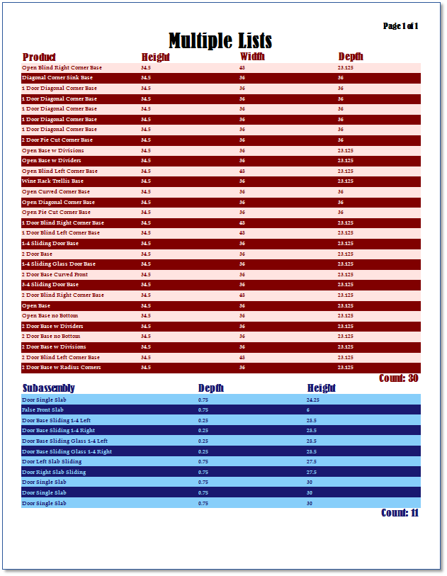

  5. Render the Report. The first Data Band renders the first list (Red). The second Data Band renders the second list (Blue).
  6. Fig. 03 – Multiple Lists Report Example
