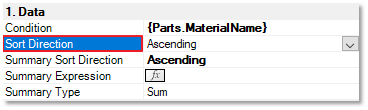

Report Designer automatically sorts the Data Rows before grouping. Ascending order is applied by default. The sorting direction can be changed using the Sort Direction property.
Fig. 01 – Sort Direction Property
There are three options for the Sort Direction property:

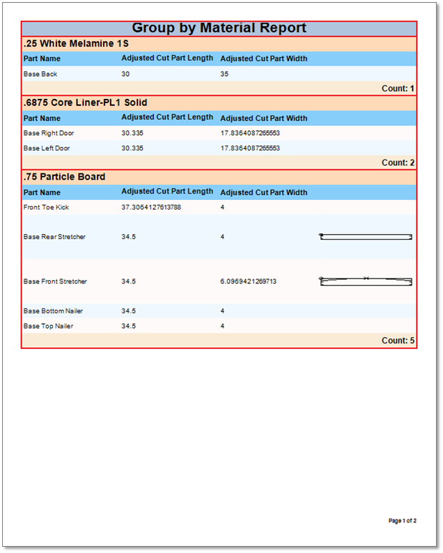

  1. None – The Data is rendered in the same order that it was passed from the Data Source.
Fig. 02 – None Applied

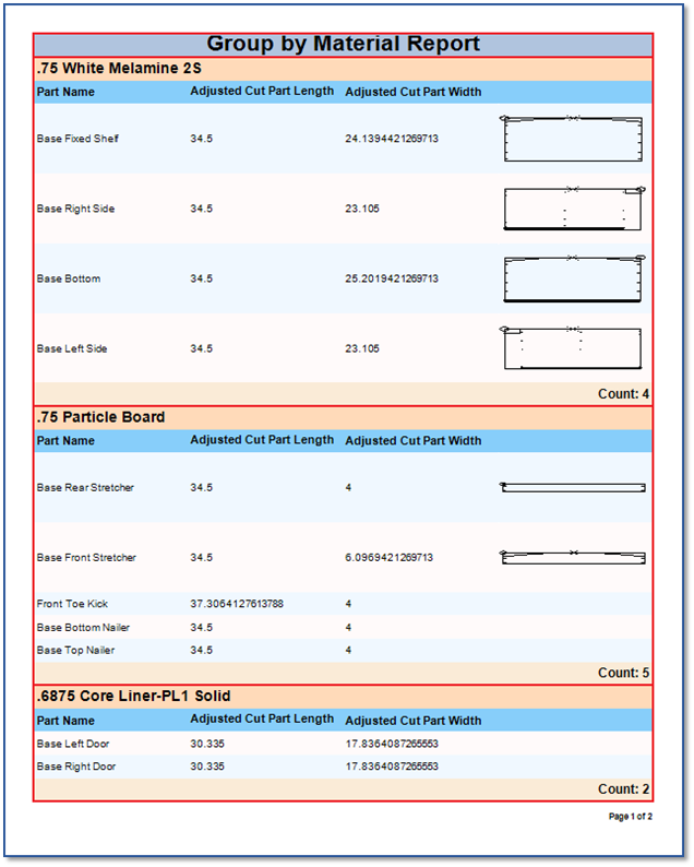

  1. Ascending – Data is displayed in alphabetical order, from A to Z.
Fig. 03 – Ascending Applied

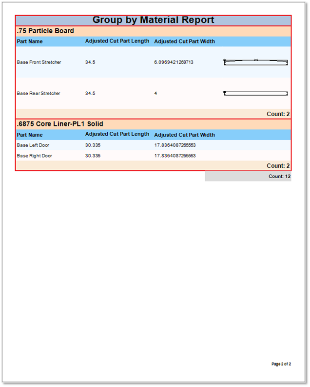

  1. Descending – Data is displayed in alphabetical order, from Z to A.
Fig. 04 – Descending Applied
