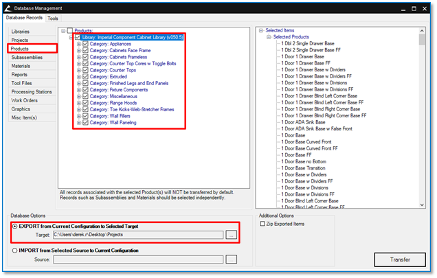

This simplified article provides a brief tutorial for exporting Products using the Database Management Utility.
When exporting Products, all records associated with the selected Product(s) are NOT transferred by default. Records such as Subassemblies and Materials should be selected independently.
Select the Products tab > select the Product(s) to be exported > accept the file to be exported to or browse for a different location.
Fig. 01 – Database Management Utilities – Export Products
