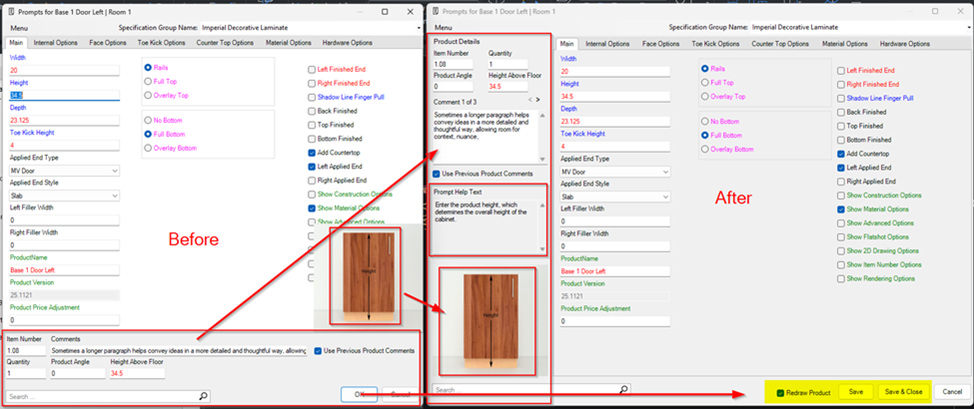

Product Prompts UI Overhaul
The Microvellum Product Prompts interface has been redesigned to improve efficiency and usability, giving users greater control over multiple features of their products. All existing functionalities of the interface remain intact, and a handful of new changes have been added:
  1. Changes can now be saved without closing the UI. Additionally, a checkbox (“Redraw Product”) has been added to allow one to control whether the product should be redrawn when its prompts have been altered and saved.
  2. Prompt tabs now stack vertically rather than horizontally in the interface, eliminating the need to use directional arrows to navigate to the tabs of the interface.
  3. The Product Details section (item number, quantity, angle, comments, etc.) has been relocated to a far more visible location on the lefthand side of the interface.
  4. There is an additional Prompt Help Text box, which retains the Help Text of the last option hovered over in the interface, allowing users to copy and paste descriptions and tool tips.

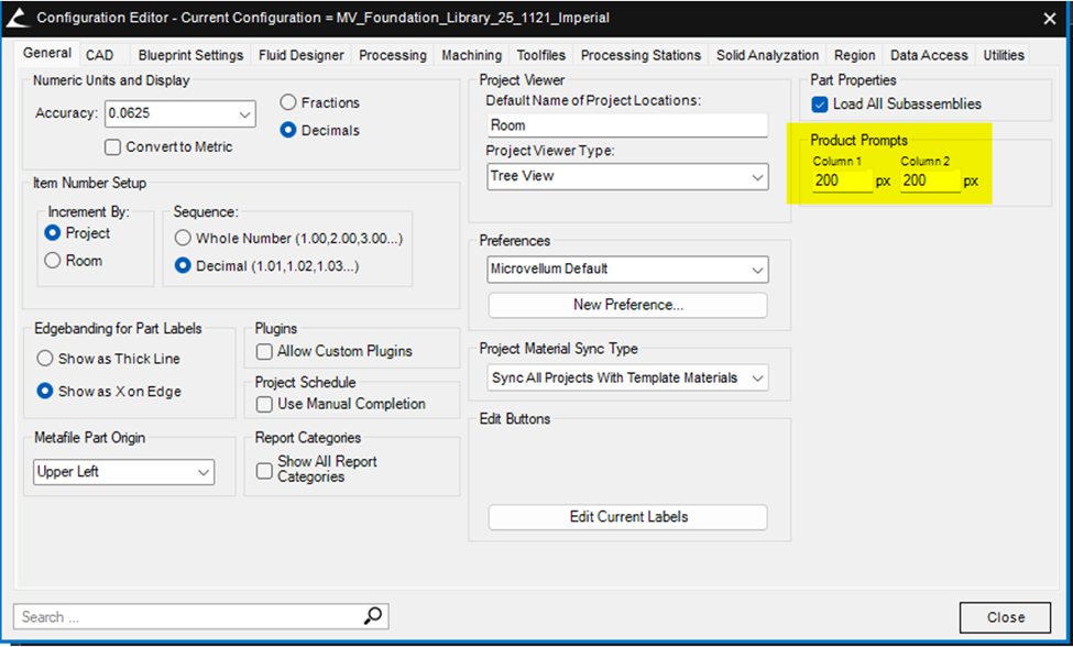

  5. There is now a setting under Microvellum Settings > Options > General called Product Prompts, which controls the width of Columns 1 and 2.

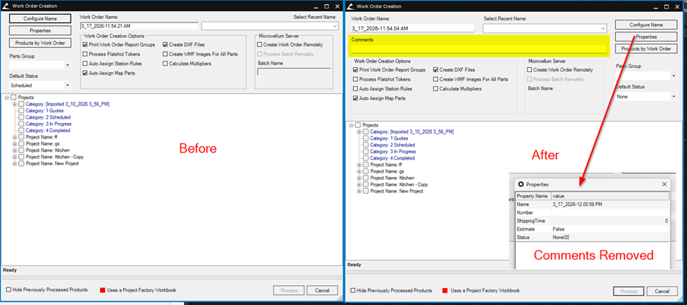

Work Order Creation UI Overhaul
The Work Order creation interface has been given an overhaul to improve usability and enhance visual cohesion. All existing functionality of the interface remains intact, with nearly all changes having been made to feature location.
  1. Buttons within the interface which open sub-menus (such as Configure Name) have been relocated to the upper right-hand side of the UI to ensure they are grouped in a single location.
  2. The Parts Group and Default Status dropdown menus have been relocated to the center righthand side of the UI for easy and quick access to either option.

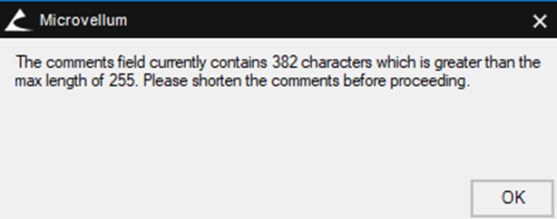

  3. A new Comments field has been added to the interface (having been removed from the Properties Interface) to allow for a much faster, easier experience, adding comments to work orders. The comments entered in this field are saved upon work order creation and can be updated if the work order is modified (existing work order comments will appear in this interface as well).
  4. Additionally, the comment field has been modified to warn users if they exceed the 255-character limit for work order comments, with work orders not being able to process until the character count is reduced, ensuring that no comments are altered or entered incorrectly, as previously, comments would simply cut off after meeting the character limit.
  5. The Work Order Name and Select Recent Name fields have been moved to the top left-hand side of the interface.
  6. All checkbox creation options and Microvellum Server checkbox options have been set in the center of the interface, for easy access.

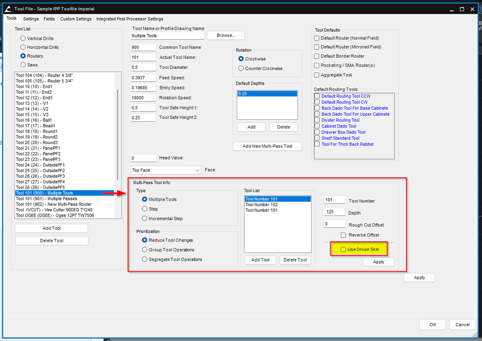

Use Onion Skin 900 Tools
  1. Previously, when using 900-series tools (multiple tools or multi-pass tools), the software was unable to support the use of the Leave Onion Skin option within Small Part Handling (leaving a thin layer of material from the first cut of a double pass for the second cut to remove). This has changed in this update, with a new checkbox, “Use Onion Skin” being added to Toolfiles when selecting a 900-series tool. This new checkbox will not function unless the “Leave Onion Skin” option in the Small Parts Handling section of the Processing Station is enabled simultaneously. When a 900-series tool is used as the Nest Border Tool and if both checkboxes are enabled, the final pass of a tool will leave the specified onion skin thickness rather than machine to full depth.

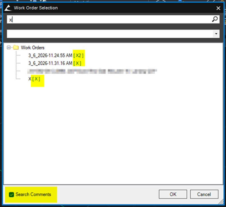

Work Order Comments Filter
  1.  When searching through large work order databases, it can sometimes be difficult to navigate or locate specific information due to the presence of many comments within multiple work orders.  To resolve this issue, a new filtering feature has been added to the Work Order Selection interface when modifying an existing work order. This checkbox, “Search Comments”, places a filtering for specific text entered in the Search Bar, allowing users to search for specific words or characters within comments of their work orders, to better locate specific work orders within one’s database.

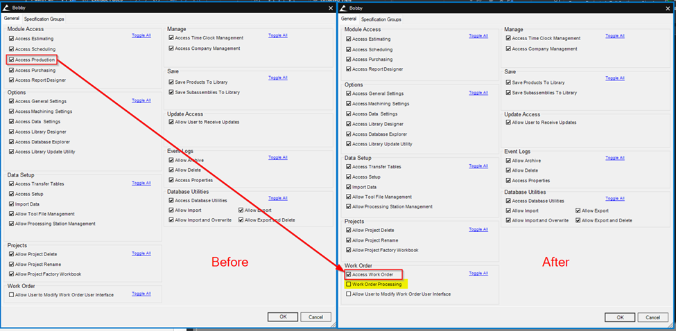

Work Order Permissions Modification For Label Only Access
  1. A new setting has been added to the Employee Permissions interface, to allow for better control over which employees can process work orders, load parts, or manage scrap. The “Work Order Processing” permission has been added to the Employee Permissions interface under the Work Order section. If this permission is left disabled, the employee in question will only be able to print labels within the Processing Center.
  2. Additionally, the “Access Production” setting within the Module Access section has been renamed and relocated. This checkbox allows the employee in question to log into and utilize the functions of Microvellum Production and the Processing Center as a whole. The setting has been renamed to “Access Work Order” and moved to the Work Order section of the Employee Permissions interface.
  3. Both changes have been applied to the standalone Processing Center application, as well as Microvellum AC and BSB.

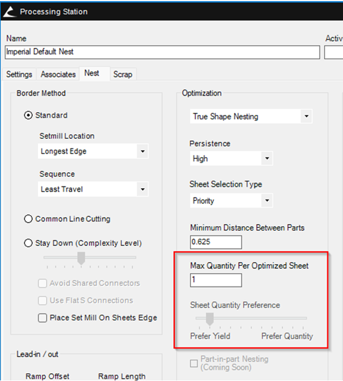

Block Nesting Improvement
  1. The efficiency of block nesting with Microvellum’s optimizer has been improved. Previously, it was reported that the current optimizer was less effective at calculating material sheet stacks during block nesting optimization than the legacy optimizer. To address this issue, the maximum quantity of sheets per stack has been increased within the coding, and a new slider has been added to the Nest Processing Station’s optimization section: “Sheet Quantity Preference”. This slider functions similarly to the “Stacked Material Preference” slider in the Saw Processing Station but applied to block nesting specifically to allow for general control over whether the optimizer prioritizes yield or quantity of stacked sheets during the operation. This setting may thus result in a significant improvement in the number of stacked sheets when using block nesting.
  2. The slider will be greyed out whenever the Max Quantity Per Optimized Sheet text box is set to a value of 1 or less. If a value of 0 or less is entered, the text box will automatically raise it to a minimum value of 1. Previously, if the value was set to 0, it would reset to a default value of 5 when the Processing Station was closed and re-opened.

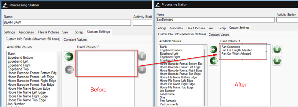

Saw Delimited Setting Fix
  1. Issues were reported with specific settings disappearing when viewing them in the processing station interface. Users who set their output type to “SawDelimited”, then assigned custom values to the saw and processed the work order found that while their custom values are visible in the XML file and processing, they would not appear in the Saw Processing Station when reopened so it appeared blank, leading to confusion. This issue has been resolved - custom values assigned to saws should appear appropriately within the values column.

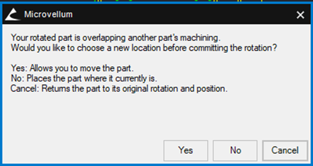

Move Part Warning
A warning has been added to the nesting tools when a part that has been moved is set to overlap with another part. When a part is detected to overlap another part, a pop-up warning will alert users, and present the following options:
  1. Yes.  Allows you to move the part
  2. No.  Places the part where it currently is
  3. Cancel.  Returns the part to is original location

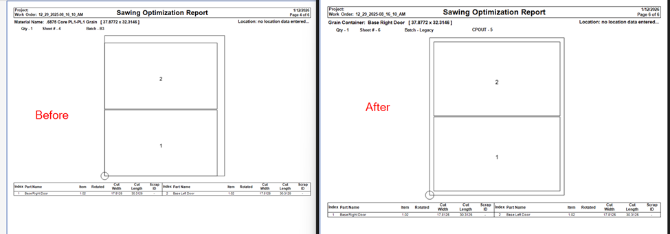

  1. An issue would sometimes occur with parts in sawing operations. When parts in a sawing operation had perfect graining applied, steps in the process such as trimming would sometimes fail to apply correctly. This would sometimes result in the trim failing to register, while at other times, it would result in other parts being cut into.

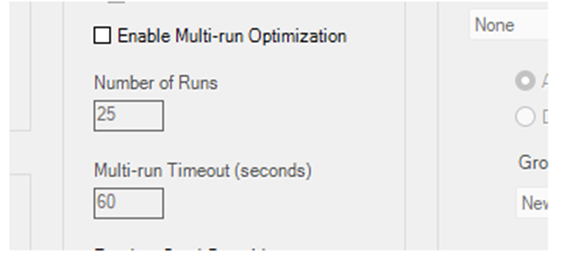

  1. A slight grammatical error between the nesting and sawing processing station, the name of the multi-run optimization setting, has been amended. Previously, the setting was referred to as “repeating optimization” in the sawing processing station, and “Enable Multi-run Optimization” in the nesting processing station.

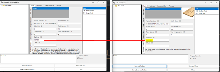

  1. Users reported an issue when Destroy Offal is turned on with True Shape set to high it was cutting into other parts. This issue has been resolved- parts should no longer be cut into due to the Destroy Offal setting. This also fixed an issue with Shadowline cutout widths varying.
  2. An issue was reported regarding incorrect part machining applied to parts rotated at specific angles. Namely, parts that were machined that were rotated at diagonal angles would sometimes be machined incorrectly, resulting in incorrectly cut parts.  This has been resolved.

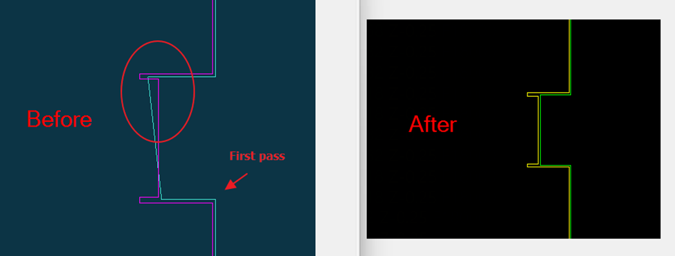

  1. A related issue was reported wherein users would have vectors of their routing machining drop during processing. Notedly, this would only occur when processed with the Machine Cannot Offset Routing (MCOR) setting enabled.  This has been resolved.

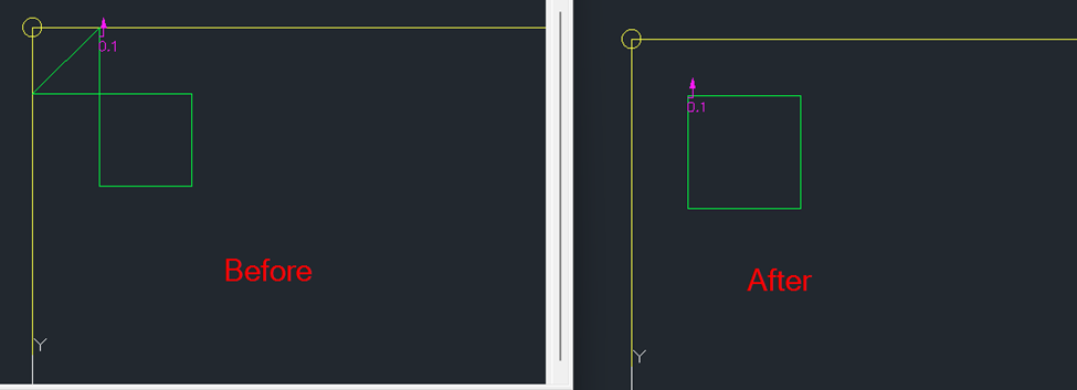

  1. An Offset Polyline issue was reported wherein extra vectors (and thus, routes) would be incorrectly added to 2D drawings, causing incorrectly shaped parts. This issue has been resolved- a coding fix was applied to enhance the software’s ability to determine whether a route is a pocket. Additionally, the default value of parameter 4 in the PLINE5 machine token has been modified from 3;0;1;0;0 to 3;0;3;0;0.

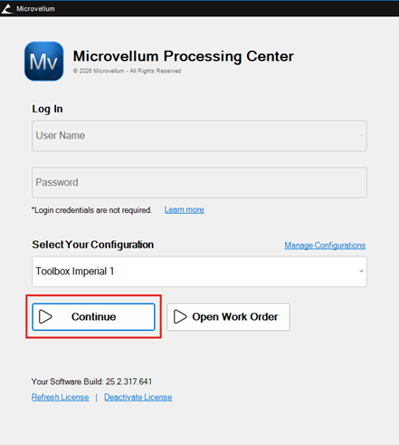

Processing Center Improvements
  1. The Processing Center standalone application is now capable of being opened without requiring a work order to be loaded within the software. A new “Continue” button has been added to the login UI of the application to allow users to open the application without first loading a work order.
