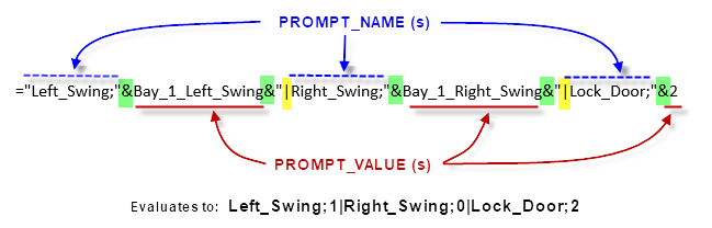

The format for the expression in the Prompt Values column of the Subassemblies tab that defines the data passed is as follows.
PROMPT_NAME;PROMPT_VALUE|PROMPT_NAME;PROMPT_VALUE
PROMPT_NAME is the subassembly prompt name that will receive the data passed. It must be the same name, in the same format, as the subassembly prompt name that is will modify. The program looks for a subassembly prompt named the same as the PROMPT_NAME parameter defined here. When it finds that name, it populates it with the value defined in the second parameter (PROMPT_VALUE).
PROMPT_VALUE is the value that you want to be passed to the subassembly. It may be a hard value or the value linked to a defined name. When the program finds a subassembly prompt named identically to the name defined in the PROMPT_NAME parameter described above, this value is populated to that prompt.
Enter the prompt name and the value you want to set for that prompt separated by a semi-colon.  If needed, you may add a second or third name/value pair. Separate multiple prompt data to pass to the S! workbook with a pipe symbol.  Concatenate or attach the various parts of the formula with an ampersand character.
You may also configure subassembly prompts that do not exist at the parent product level. Figure 1 contains an example of this (Lock_Door). It illustrates a data definition expression or formula containing defined name values, hard values, pipe delimiter characters, and the ampersand character.
Figure 2 contains an example of defined names, pipe delimiter characters, and the ampersand character, but no hard values.

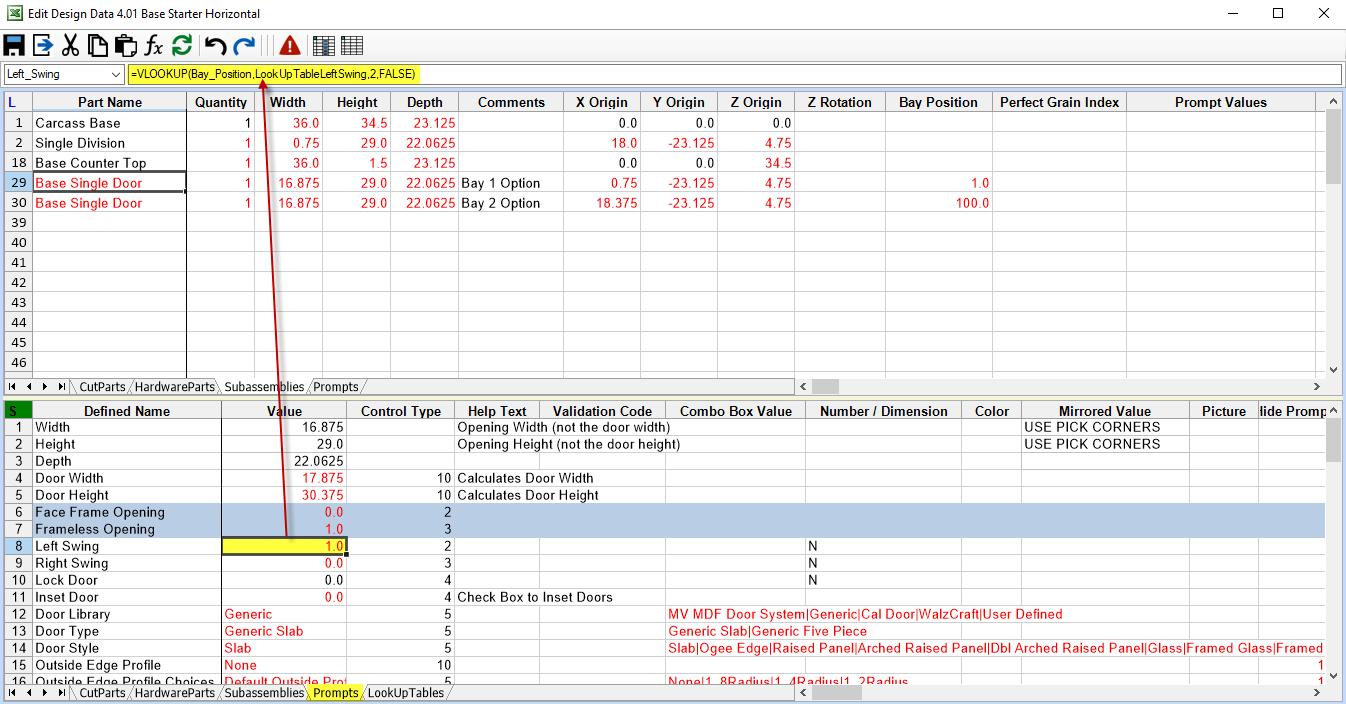

Figures 3 & 4 show the previous method of setting the door swing of a Base Single Door subassembly. It involved the use of a VLOOKUP table, acting as an intermediary between the product prompt and the subassembly prompt. This example illustrates a simple lookup table, but the same principle holds true for more complex lookup tables.
Fig. 3
Notice that the value of the subassembly prompt Left_Swing is shown in red, meaning that it is an evaluated formula. Verify that by looking at the VLOOKUP function in the formula bar.
Fig. 4

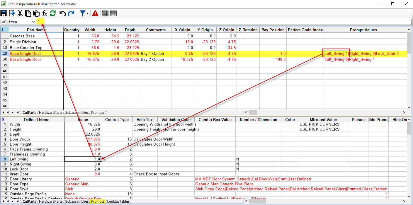

Figure 5 shows a new method for setting the door swing of a Base Single Door subassembly. It eliminates the complexity of the lookup table in favor of a simple formula to pass the data through to the subassembly prompts.
Fig. 5
Notice that the value of the subassembly prompt Left_Swing is now shown in black, meaning that it is a hard value. Verify that by looking at the formula bar where the parent product prompt value has been populated.
