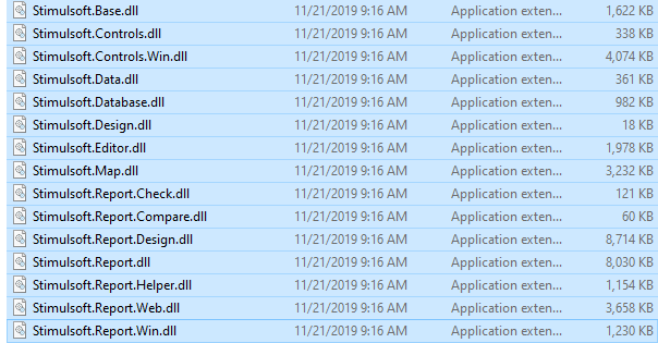

Manually delete Stimulsoft assemblies
Delete these files (as shown below) by following the file path provided in the notification.  Deleting these files is necessary and may require elevated user account privileges (as mentioned in step two).
