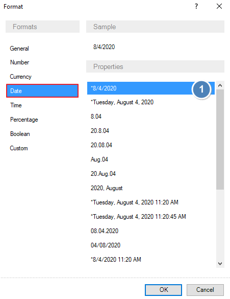

By default, the date and time are displayed when the Date Format mask is applied to a text component. Different Date Format masks can be applied to the data columns above. Select the text component, open the Text Format window, navigate to the Date tab, and select the appropriate type.
Fig. 01 – Text Formatting > Date Tab
  1. Date Format – This box contains all of the available formatting masks to be applied to a date.
