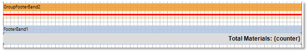

Figure 02 features an example of the Horizontal Line primitive in the Report Template. This line is placed on an empty footer band and used to separate the groups within the report visually.
Fig. 02 – Horizontal Line in the Report Template

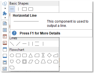

The Shape is a component, which, depending on the type, shows this or that primitive. The Shape Type property is used to specify a primitive type.
Fig. 03 – Shape Type Property
Fig. 04 – Available Shapes

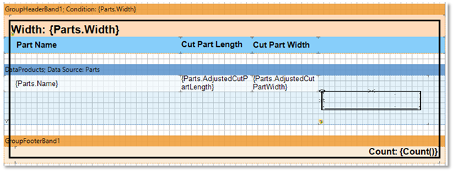

Cross-Primitives differ from standard Primitives in that the start and endpoints can be placed on different components of a report. Figure 05 features an example of a report template with a rectangle.
Fig. 05 – Cross-Primitive (Rectangle)

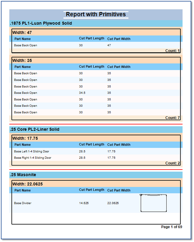

As demonstrated, the start and endpoints are located on different bands. When this report is rendered, it looks like Figure 06. Note how the Primitives and Cross-Primitives can improve the look of a report.
Fig. 06 – Report Example
