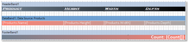

Footer bands are generally used to print totals for the data. The Footer band is placed after the Data band, and this is reflected in the rendered report. Insert a Text component inside the footer and enter the expression of your choice.
In this example, I’ve entered “Count: {Count()}” in the text component.
In Figure 01, a report template with the Footer band is displayed.
Fig. 01 – Footer Band in the Report Template
