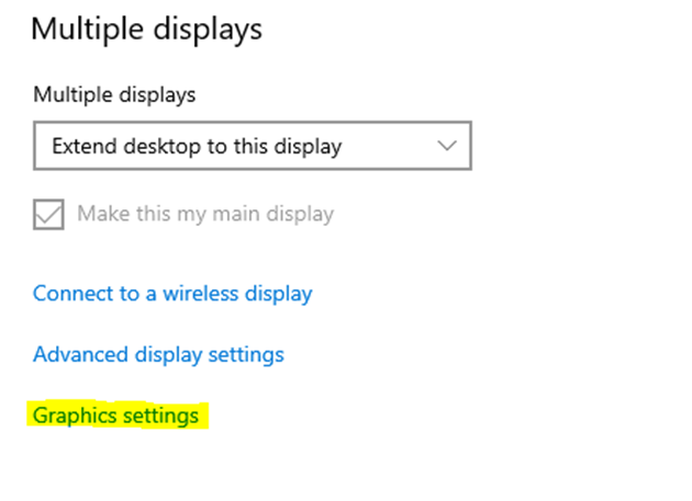

How to Change the Graphics Settings in Windows
1. Right click the desktop and choose Display settings.
2. Scroll down and select Graphics settings.

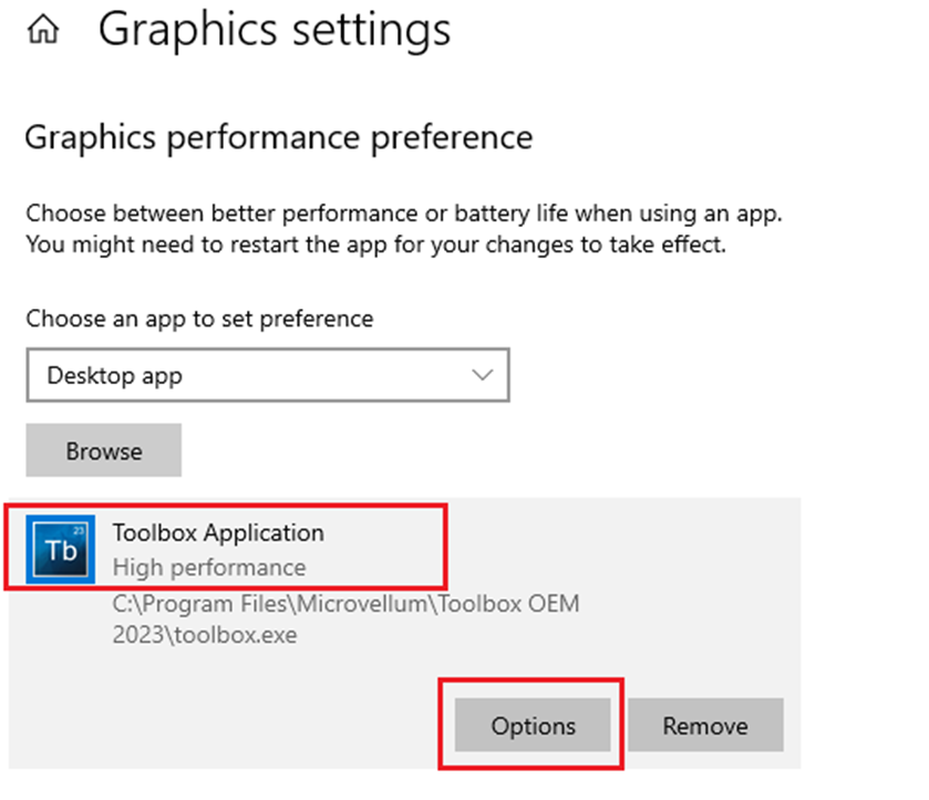

3. Click Browse and then navigate to and select the software executable. For Toolbox 2024 it would be C:\Program Files\Microvellum\Toolbox2024\toolbox.exe. Double-click toolbox.exe to add it to the list.

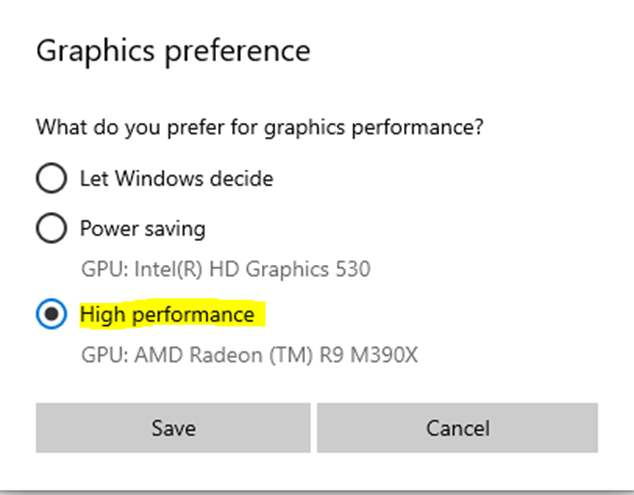

4. Select the High-Performance option, then click Save and close the Settings panel.
5. Relaunch or restart the software (if it was running) and look within the program to confirm that the high-performance device is enabled.
