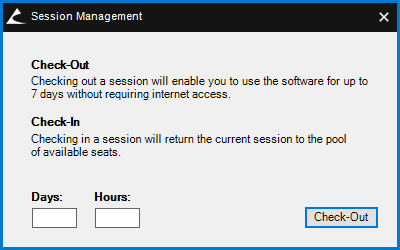

Session Management for FLA Licenses
  1. What it is: Sessions are manually determined spans of time wherein one can download a temporary local license that will allow the software to function offline, for a period of up to 7 days at a time.
  2. How to do it: Checking out a session can be done either in the splash screen that appears when one first opens the software, or in the About Microvellum UI, by clicking the "Session Management" hyperlink at the top right corner of the interface.
  3. Limits: Checking out a session removes an available seat from your license's pool for the duration of the session. It also requires internet connection for the initial checkout, so one may have issues completing the initial checkout if one is having an outage.
