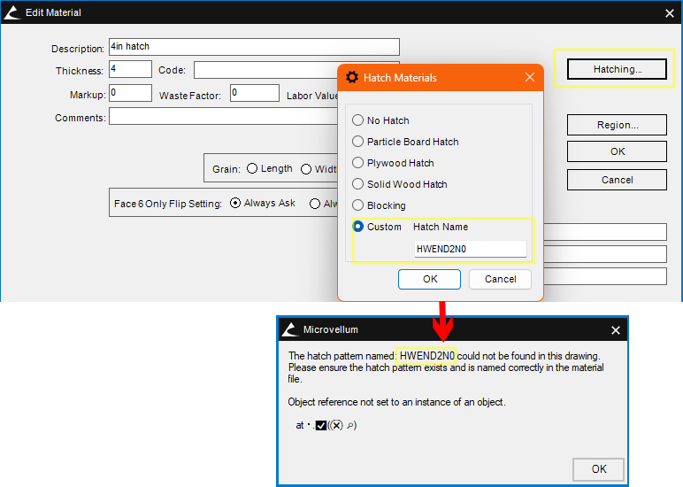

Custom Hatch Pattern Fix
  1. An issue was discovered when users attempted to create custom hatch patterns to be applied to a material in Toolbox BSB. It was found that when attempting to apply a custom hatch pattern to a material, the hatch pattern would error out and be rendered unusable. This issue was determined to be caused by a coding difference between AutoCAD and BricsCAD when the end user searches for hatch materials. This has been resolved, and custom hatch patterns should be able to be created and applied to materials without issue.

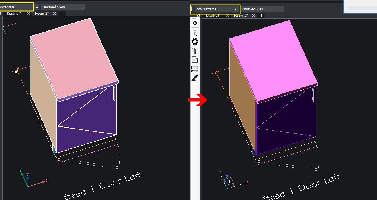

Visual Style Fix
  1. When switching visual styles and redrawing products in Toolbox BSB, an issue was reported. When redrawing a product, it is expected that the product will temporarily switch from the current visual style to the default 2D wireframe visual style, due to that style’s low processing time, leading to decreased time waiting for a model to redraw. However, it was found that when users redrew a product, it did not temporarily switch to the 2D wireframe style, but instead would default to the Conceptual style, which would increase the model’s generation time. In these cases, the software would erroneously register the Conceptual style as the 2D Wireframe style.
  2. This issue has been resolved. The visual style in BSB should properly revert to 2D wireframe by default when regenerating models.

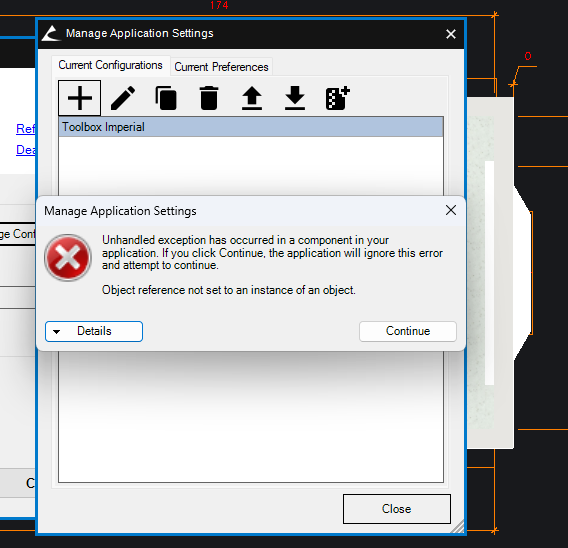

Configuration Fix
  1. When managing configurations and attempting to add a new configuration in Toolbox BSB, certain users experienced an unhandled exception error. This issue was found to be experienced by users who had Toolbox BSB installed, but no other Microvellum software installed on their device, as the software was scanning for other installations so it could create identical configuration conditions. A coding change has been applied to resolve this issue, and users should be able to create configurations without error.
