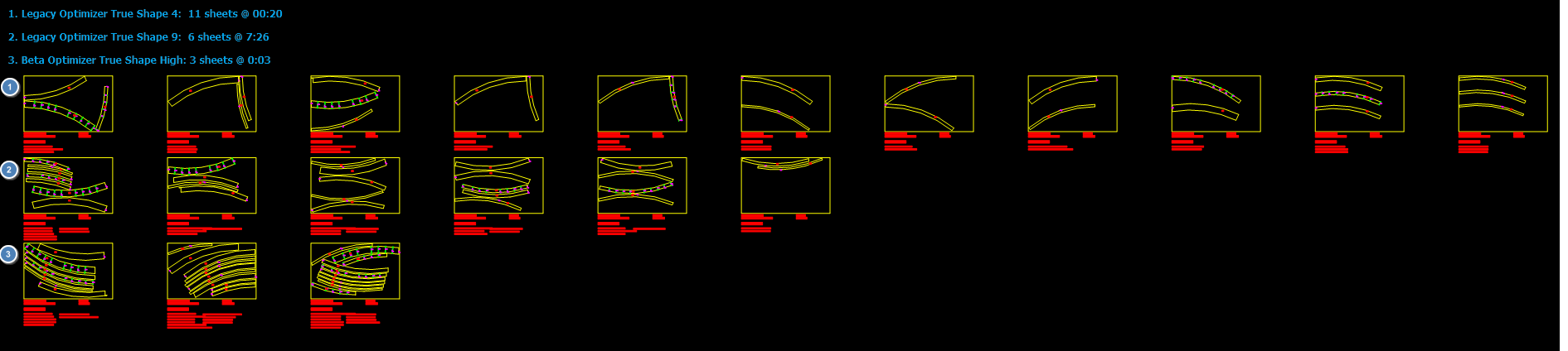

Beta Optimizer True Shape
Fig. 1: The new True Shape option in the Beta Optimizer.
Microvellum’s new Beta Optimizer (see the build 25.1.0325.641 release notes for more information) has added functionality for true shape nesting. While results may vary between different machines and software configurations, extensive testing of true shape nesting in the Beta optimizer has concluded with a significant improvement across the board in optimization performance.

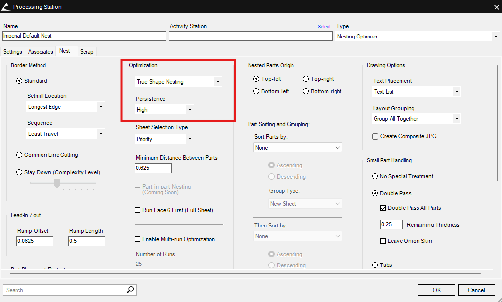

  1. Enabling true shape nesting can be done in the "Optimization" section of the Processing Station, if your software is set to use the Microvellum Beta Optimizer.
  2. Rather than a scaling bar, you can select between low, medium, and high persistence level using a convenient drop-down menu.

The Beta Optimizer with true shape nesting enabled has consistently displayed a significant increase in the speed of optimization, as well an increase in the yield of materials.

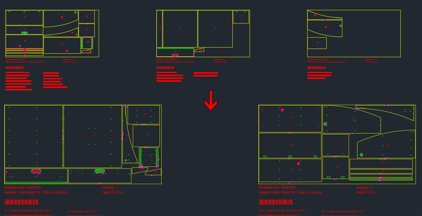

Fig. 3: An example order processing multiple sheets with arcing parts with True Shape enabled.
  1. Work orders containing multiple parts with complex shapes (such as arcs) were processed significantly faster across multiple tests, sometimes 50-80% more quickly than in the same order in the legacy optimizer.
Fig. 4: A product that required 3 sheets in the legacy optimizer (top) vs 2 sheets in the beta optimizer (bottom)
  1. Tests of yield and part placement on sheets demonstrably improved, with some projects containing parts that were spread across multiple sheets in the legacy optimizer instead being placed more precisely on fewer sheets of material.

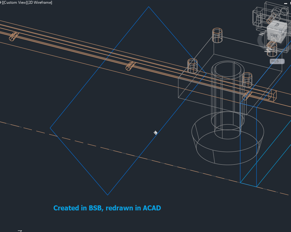

Fig. 5: The shrunken annotative text issue.
  1. There were reports of an issue with annotative text scaling in Toolbox BSB, which would primarily occur when transferring product drawings to or from Toolbox AC. The text would often appear scaled far smaller than intended, sometimes to the point of being unreadable. This issue has been resolved with the new Toolbox templates.

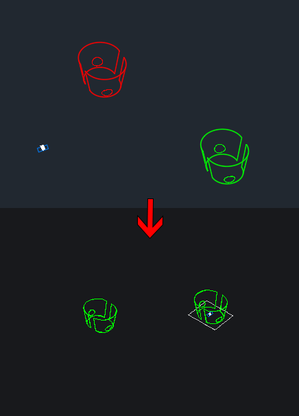

Fig 6: Incorrectly analyzed solids (top), and corrected solids (bottom).
  1. There were reportedly issues with the analyzing of solids using SMA based on the version of Toolbox one was using. Solids that are successfully analyzed in Toolbox BSB, when imported or opened in Toolbox AC, would not analyze correctly. Solids may be placed off center, materials not selected, or other problems may arise. This issue has been resolved. Analyzed solids should no longer have an issue of incorrect analysis between different versions of Toolbox.

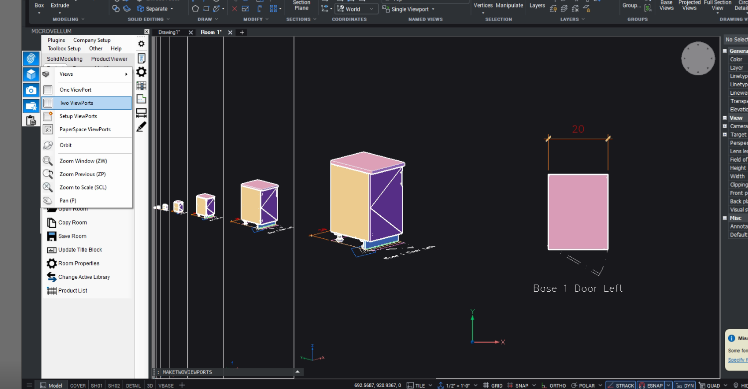

Viewport Issue
Fig. 7: Infinite viewports caused by the issue.
  1. It was found to be the case that a graphical error requiring the manual closure of the software would occur when altering views using Viewport. If switching between 1 and 2 viewports using the Microvellum Navigate Menu button in the Toolbox Palette panel, it was sometimes the case that the software would create an excessive number of viewports that were unable to be closed. This issue could only be resolved by manually closing the software. This issue has been resolved; switching between viewport configurations should no longer cause multiple viewports to open.

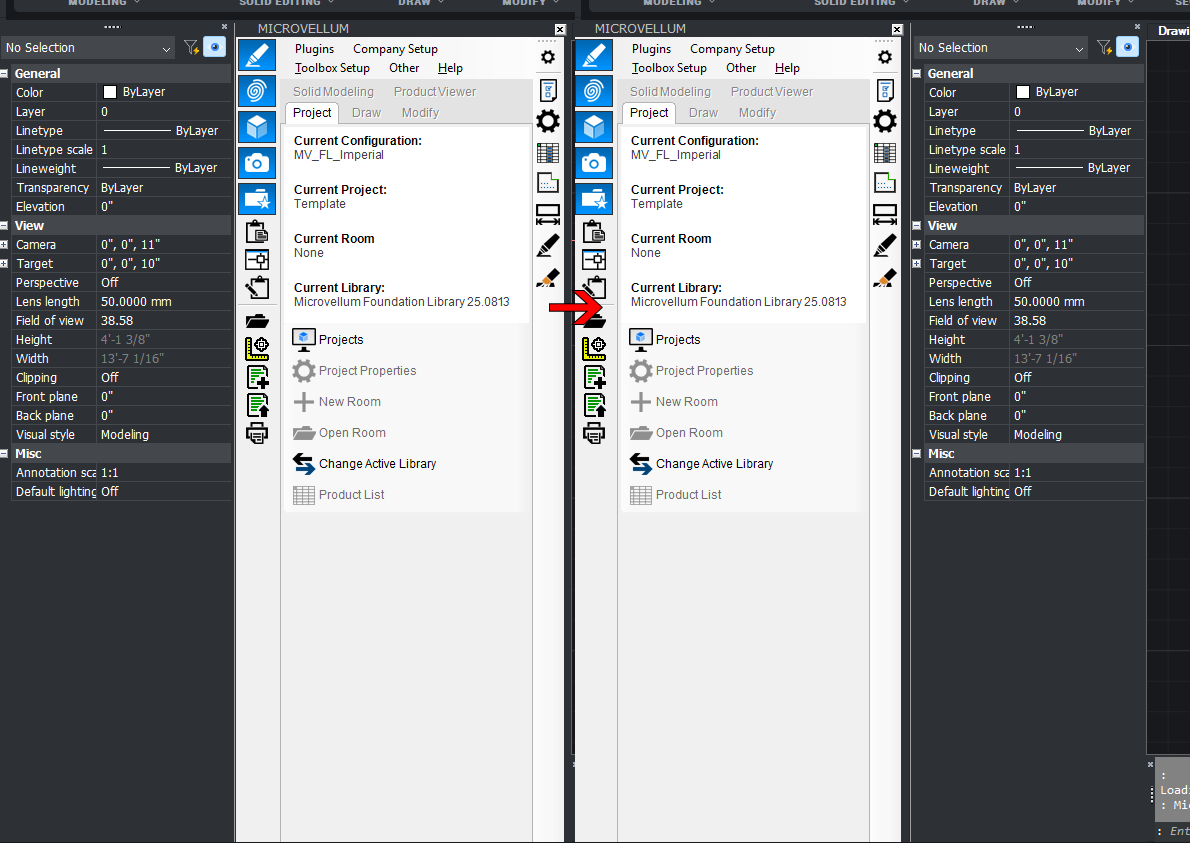

Fig. 8: The toolbar moving the Toolbox Palette (left) and the correct docking position (right).
  1. An issue was reportedly occurring when attempting to adjust the position of BricsCAD toolbars relative to the Toolbox Palette. The BricsCAD toolbars would consistently be mounted to the lefthand side of the Toolbox Palette, even if placed on the righthand side of it. This issue has been resolved, and toolbars should be docked correctly relative to the Toolbox Palette.

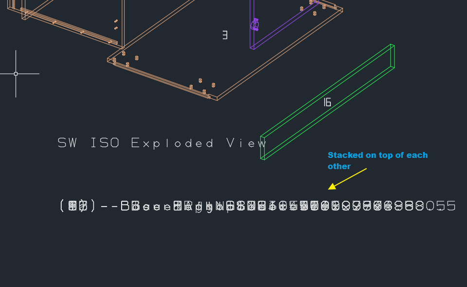

Dynamic Image Text Fix
Fig. 9: Dynamic Image text with characters stacking atop each-other.
  1. When creating new text styles and setting them to the default for Dynamic Images, it was sometimes found that the text of the dynamic images would be created incorrectly. Characters would be placed on top of and next to each other, leading to an unreadable format. This issue has been resolved- new text styles being created in Dynamic Images should display characters correctly.

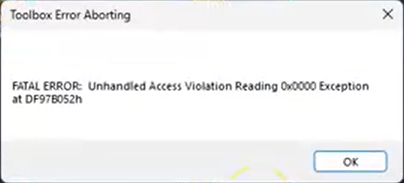

Fig. 10: The fatal error message when redrawing products.
  1. Some users experienced a fatal error that would occur when redrawing products in 2D drawings. Noticeably, this fatal error would not occur when the same 2D drawings were redrawn with their top sections removed. This issue has been resolved- the fatal error should no longer occur.

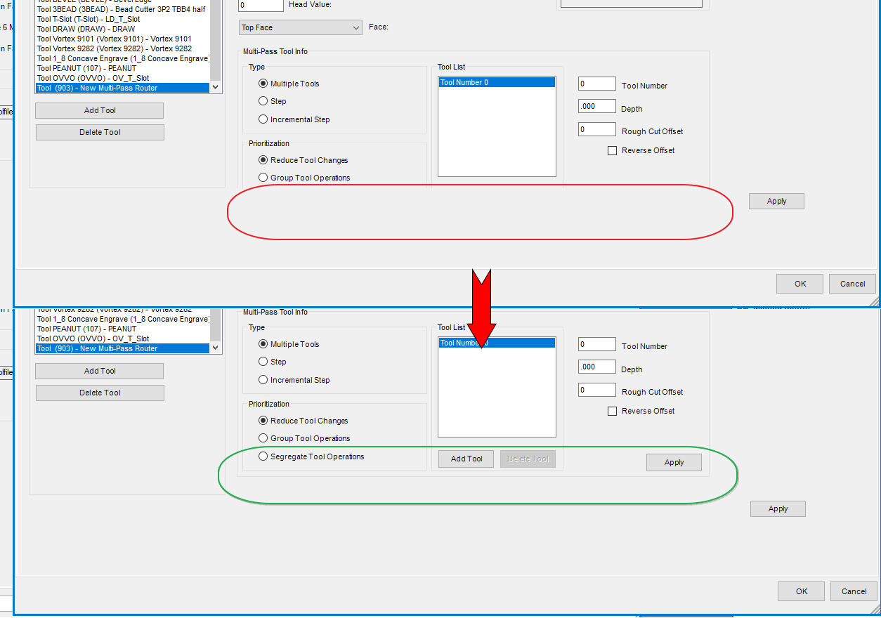

Fig. 11: The Toolfile UI incorrectly scaled (top) and correctly scaled (bottom).
  1. An issue was reportedly occurring regarding the scaling of the Toolfile UI. When installing on a new device, some users found that the Toolfile interface would not scale properly to their screen, resulting in some options, such as the option to set up multipass for tool operations, not being selectable or visible on the menu. This issue has been resolved- the UI of the Toolfile has been adjusted to scale correctly universally to ensure that users do not lose access to any portions of the menu.
