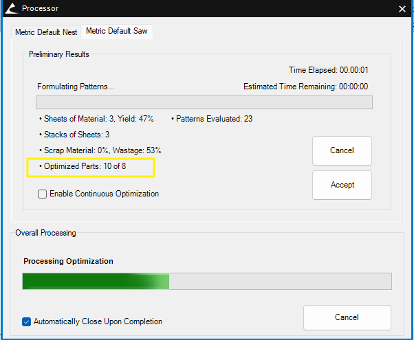

Fig. 1: Perfect graining containers erroneously counted as optimized parts.
  1. When processing parts with perfect graining containers, it is not intended for those containers to be counted among the total number of optimized parts. It was reported that sawing operations with perfect graining containers included would erroneously have the containers appear within the total of optimized parts within the processor interface. This issue has been resolved- the UI will no longer incorrectly display perfect graining containers in the processing interface.

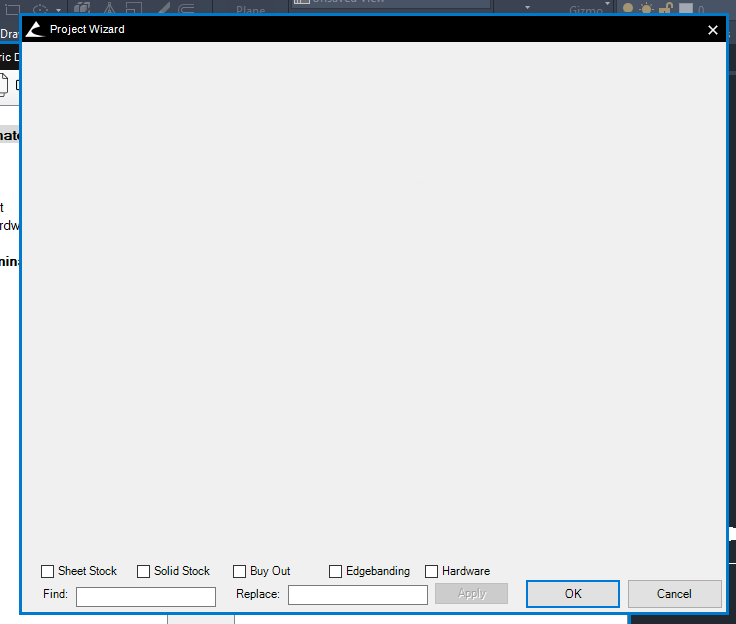

Project Wizard Fix
Fig. 2: The Project Wizard UI blank after the Prompts change.
  1. When working within the Workbook Designer, an issue was discovered with the Project Wizard deriving from changes in Workbook W. When working within the W workbook, any change to the name of the first prompt (Default Construction) in the N column of the Prompts sheet would result in the Project Wizard failing to load properly, rather than simply changing what tabs are available to view within the Project Wizard. This issue has been resolved- altering the name of the prompts should now simply remove that prompt or tab from view, rather than cause the entire wizard to fail to load.
