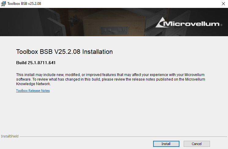

3. The installation interface will pop up with a link to the latest public release notes. Click “Install”.

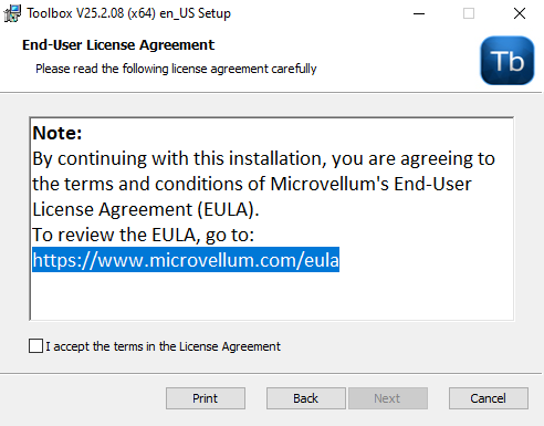

5. A page containing the End-User License Agreement (EULA) will appear. Copy the link to the EULA page, paste it into your browser, then read it. Once finished, check the box to agree to the terms in the License Agreement, and click “Next”.

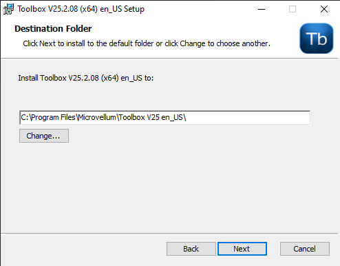

6. Set the desired installation path within the interface and select "Install".

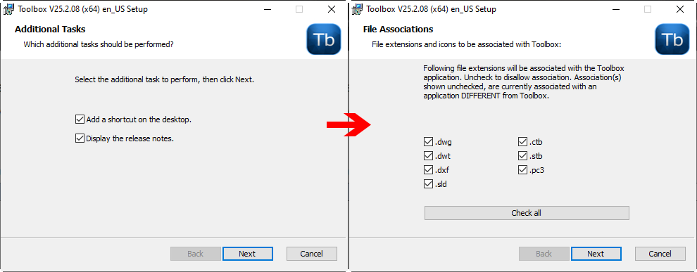

7. The interface will prompt you to select whether you want a BSB shortcut to be added to your desktop (Microvellum recommends that you do). Then, you will be able to select the specific file extensions you would like to associate with Toolbox BSB by default. Once your selections are complete, click "Next".

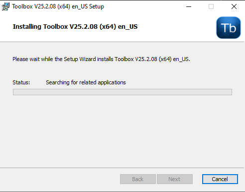

8. The installation process will then begin. The installer will search for any related applications installed on your device, calculate the appropriate storage space, and install the software. Once the installation reaches 100%, you will be notified and have the option to launch BSB immediately. If any alerts pop up regarding issues with the installation process, resolve them before repeating steps 2-9.
