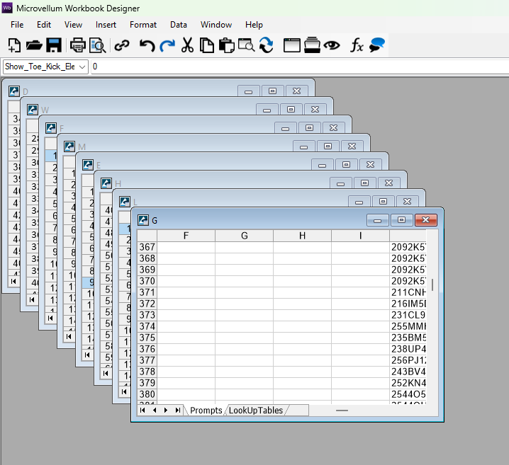

Global variables can be altered through the Global File interface, but the data is saved to the G! workbook. As such, any customizations that have been applied to one's Global Variables will be visible in this workbook, presenting an easy means for saving and applying your customized global variables to your new Foundation Library. To access your G! workbook:

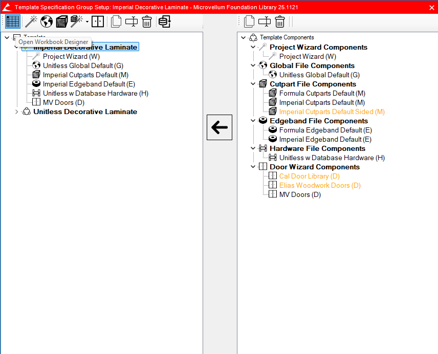

  1. Open your Library Specification Groups under Toolbox Setup.
  2. Click the icon in the upper left corner to open the Workbook Designer.
  3. Navigate to the spreadsheet titled “G” and set it to full screen.

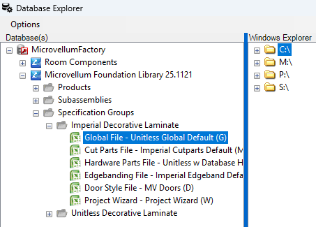

Alternatively, you may create a copy on your local disk using the Database Explorer utility in MIcrovellum, which will add the file extension automatically. To create a copy this way:
  1. Open Toolbox Setup>Options>Utilities>Database Explorer.
  2. With the utility open, in the Databases column, open MicrovellumFactory>Your version of the Foundation Library>Specification Groups>Imperial/Metric Specification Group.
  3. Select your Global File.
  4. Open your local disk drive in the Windows Explorer column (usually C:\).
  5. Navigate to the specific location on your disk you wish to copy the Global File to (such as Documents, Downloads, a specific folder, etc.)
  6. Drag and drop the Global File to your intended location. This will create a copy of the file with the correct formatting automatically.

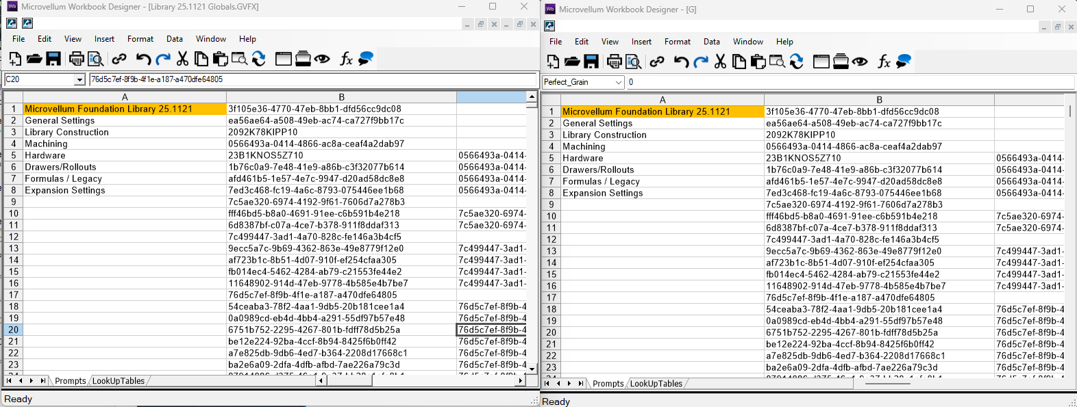

With your new library downloaded and installed, you can begin the process of re-adding in your custom global variables from your copied workbook to your new workbook.
  1. Open your copied workbook. This should open in the standalone Workbook Designer application (provided the file was saved correctly with the GVFX extension.)
  2. Open the software and access the Workbook Designer feature from within the Library Specification Groups interface.
  3. With both workbooks open, copy the desired Global Variables from the other/older library.
  4. Paste the variables either at the bottom of the worksheet or adjacent to variables in the same category.
    1. The variables will be visible in the worksheet but are not yet defined. Variables must have a defined name for them to function properly as a global.
  5. Highlight the name and the value of the variable and select Insert from the top left drop-down menu.
  6. Find the ‘Defined Name’ option in the menu and select ‘From Selection’. A dialog box will appear to select an option to ‘Create Names from Selection’. Leave as Left Column.
  7. The highlighted cells will now be instantly defined, and you can see the change takes place in the top left drop down menu for defined names.
  8. Check for overlapping names in the ‘Name Manager’ after adding variables to your worksheets. Ensure there is little to no overlap, or it may interfere with the function of the variable.
